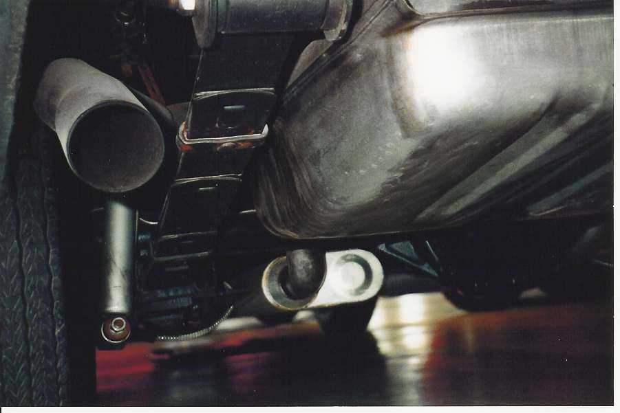

Sorry dude! I suffer from CRS
Here it is.

Yes it still has the original springs with the square lumps? It also still has the flowmaster exhaust, which is going.
On another note did these cars use the crossflow muffler-aka- Camaro type?

rz, It's a Hurst shifter, yes they use the crossflow muffler setup with resonators. If you're going to change back to an M21 you'll need to change the drive shaft yoke. M22s are different ie; bigger output shaft. I kinda like the M22 in mine. Nice whine Schonye
