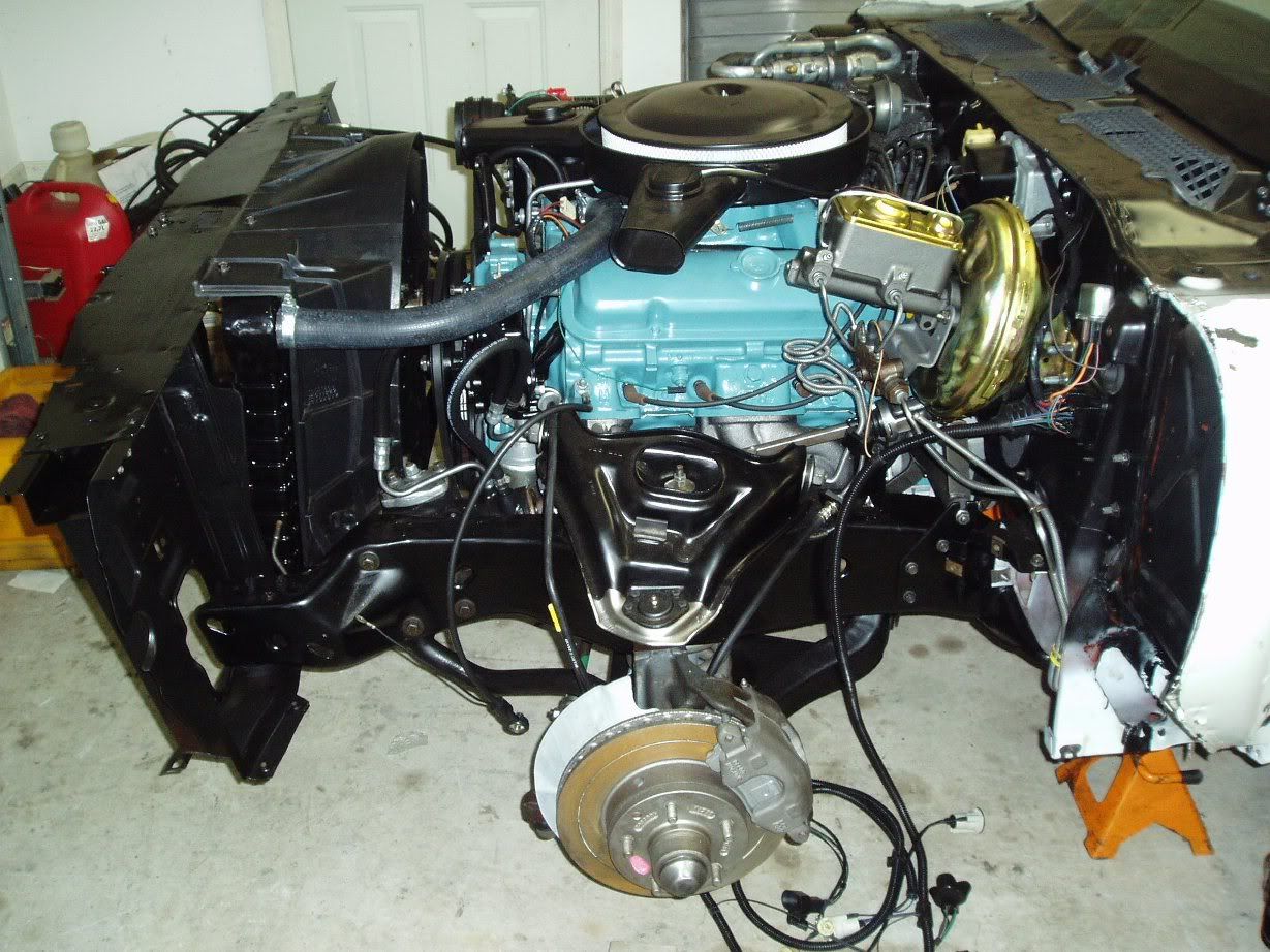

I removed the doors and trunk lid and loaded the front sheetmetal up, to bring them to Enoch tomorrow so he can start on them. This way he can have 1/2 the car semifinished when the body arrives. More evidentiary photos show that these cars must have had their doors and trunk lids installed when they went through the red oxide primer dip. Notice that there is no primer under the hinge area at the door jam and only some seepage on top of the trunk hinge where the shims left a gap.

Default Re: 72 T/A progess
Here's how she looks at the moment:
