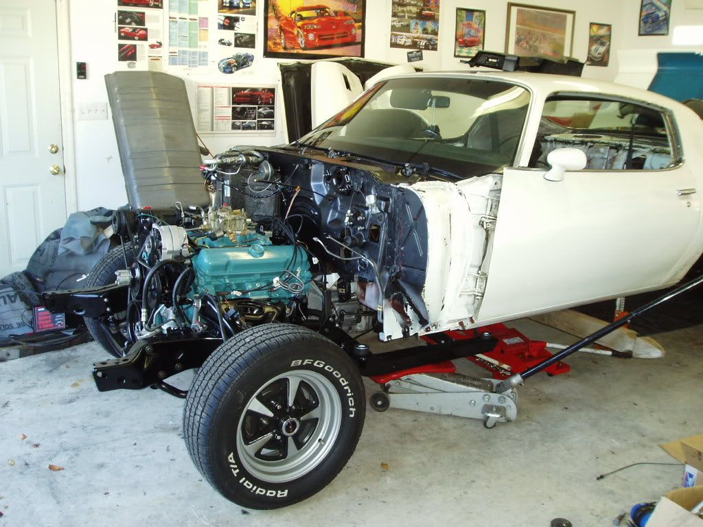

These are the clutch related parts I had to replace on my 114,000 mile Trans Am. I will have to weld up the elongated clutch pedal hole but look at how much of the linkage parts were worn through after 33 years of heavy shifting. By the way, these pedal is as it came out of the car: that's the original finish on it -still no rust after all these years!

I installed the subframe on the car today. It actually went very easy, just rolled it back on the floor jack and lifted the body with a transmission jack with a 8-foot fence post supporting the body.
