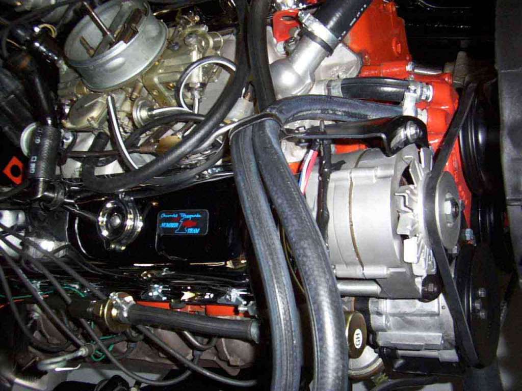

See if these pix answer your question.
Dennis

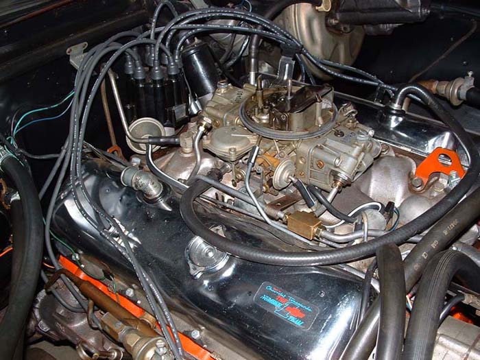

Default Re: 70 Chevelle TCS Harness
Another view

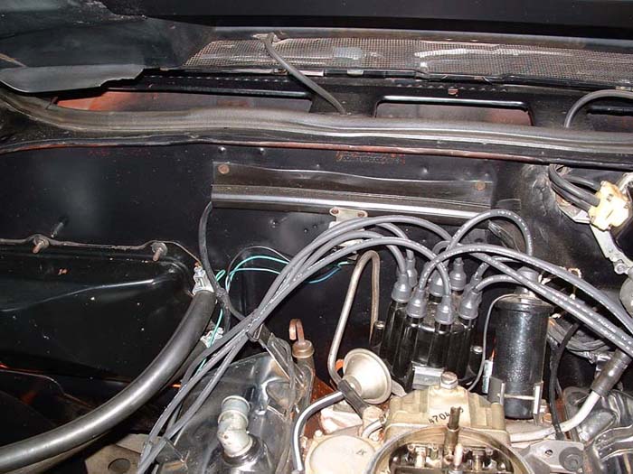

And a third
