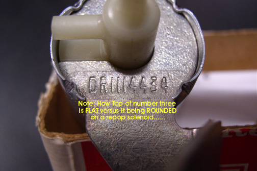

Just want to mention that the 432 and 434 TCS solenoid switches are both being repopped......I bought a 434 several years ago advertised as NOS and it turned out to be repop.....One tell tale difference is that G.M. original have a FLAT TOPPED numeral 3 .....unlike this ROUND top 3 !!! .....see my attachment....Chuck Sharin
Chuck Sharin
