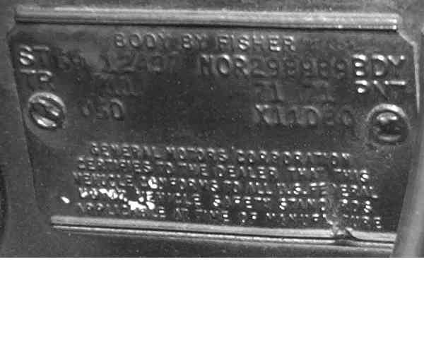

Here's a shot of my trim tag for all to see, and let the guy with the SS427 go sulk in the corner. Go call a clone a clone and still get compliments for having a nice car.
Andy
COPO 9561/9737 M40 X11D80

Andy, that sure looks like a possible COPO based on the body #. Have you had E.C. look at it?

Already replied directly to Fred. This one's a hard one to prove w/o docs.
GarnetM20, I am looking at a possible copo. It's body number is close to yours. 06A X11D80 NOR345421 Roger
This one is a little more doubtful. It's a BB street machine, SB heater, drum brakes, vinyl top is gone.
What's the axle code?
Kurt S - CRG

X codes started late November/ early December, 1968. D80 was added to the tag in April 69, I think. So any SS350 built after that date with style trim (including RS) ordered with a spoiler, would be X11D80. That does not mean yours was an SS, lots of clues lead to possible COPO. The more clues you have, the better the likelihood. Single 3/8" fuel line is another on your list. Sounding more and more likely!!!

Unreal, I just went to the CRG site to confirm this question. An SS350 can be X11 or X55, the X11 has the brite drip moulding, quarter moulding etc...So correct me if I'm wrong, slap on discs brakes, SS hood, 12bolt rear, instant SS350 car? Not trying to light a fire here, it's just that you see alot of SS350 X11 cars on EBAY and my thought is unless they have some other document, who knows if they really are an SS350? I know that a SS350 is nowhere in the league of the BigBlock or Z28 cars but it still could be a cloned car. Thanks Brent
