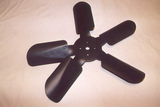

Is this the 5-blade fan you are talking about? Came on a '69 BB I am using in my Camaro. The numbers on the blades though are 24654 and 3462190 with k75 on it. It is a flex type fan, no clutch.

This is the correct 5 blade fan for a BB Nova. I believe the reason it's clutchless is, there just isn't enough room to fit a clutch. It's only a couple of inches between the water pump and the radiator. I've also never seen a part number on one. I stole your pic Greg hope you don't mind. m

Any ideas on what the fan I have is from? Can I assume that the numbers tell of a 1965 or 1975 date code?

K75 date code stands for November 1975.

Thanks, looks like the same general shape and design as the one you guys are talking about, except for the rivets and that it is an aluminum flex type fan. Maybe would provide decent cooling? Thanks again to everyone.....what a great resource you all are!
