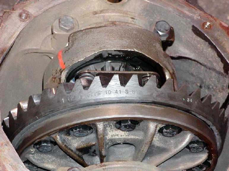

Is there a correct part number for the posi unit on BE axles? I have read somewhere that the unit was machined different, different guts, and such...What posi unit is correct for a BE...

OK, I guess I have the correct unit. Are these date coded anywhere? And, Do I understand that these may have been available over the counter??? Im trying to determine that this unit actually came out of my axle I have....

Interior shot of the plates and springs...
