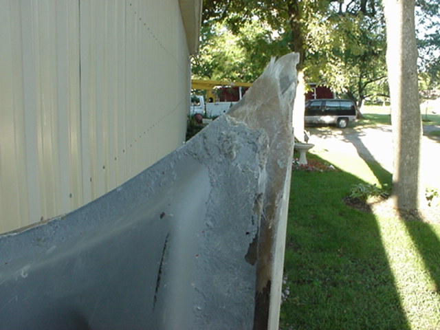

John when you wait 8 weeks for their Great hood and it's 7/16 too narrow in the back and 3/8 too wide in the front and the inner structure in the front hits the rad support and it sets 2inches above the front fenders it's crap pic enclosed
Jake is my grandson!! |

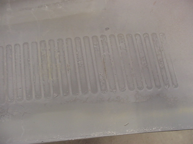

another pic

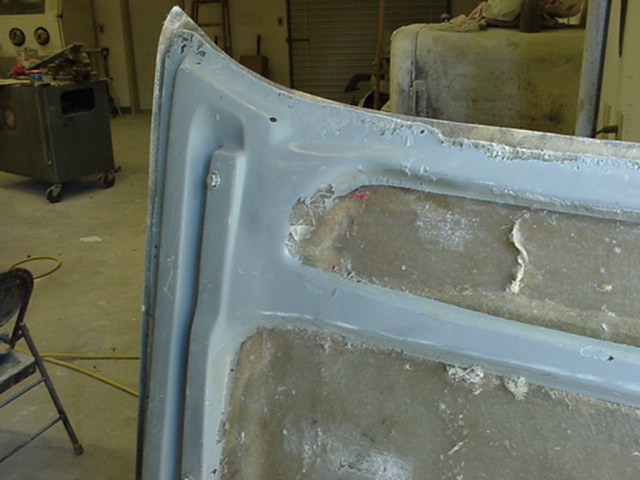

I don't think the quality of the Legendary hoods is the highest on the market. I got two hoods with the 87 Motion Monte Carlo and the used one is cracked around the hood latch area. The bottom of the hood has a thin plastic panel that is bonded to the top panel. It does not look strong enough to hold down the hood unless hood pins are used. The second hood is new and made the same way.
#18
JoeC
I did not mean the L-88 hood from Legendary is the best quality available, just that out of all the hoods I've seen from them the one I received is the best one I've seen them make. I think Hardwood makes the best quality hood of all the manufactures. The L-88 Nova hood I rec. from legendary fits great, is not wavy and the underside's fit and finish is some of the best work I've seen on any hood. The cosmic tumblers at legendary must have all been aligned that day. I do have to say the L-88 Vega hood I bought from them was crap. Wavy, cut to short and the hood hinge bolt holes were crooked. I have yet to hear any good comments about th stuff from Unlimited. |
