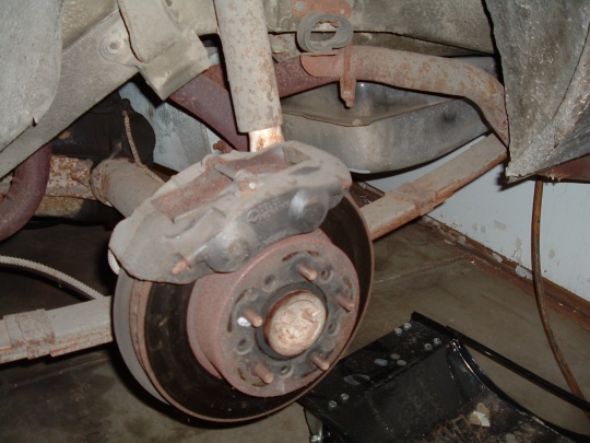

axle info as follows 02559 bu0515g1 531/4"wide flange to flange has the correct rear disc on the axle appears to be factory bolts have no evidence of ever being turned backward 113/4" on the front but the trim tag is way off of the vin the previous owner is trying to get me some more info trim tag 09a 12437los103128 has original gm rivets the vin matches everywhere 12437L526322 .thanks for your input stan in ga.
Attachments - The Supercar Registry 69565-2004_0130Image0007a.JPG 69509-2004_0130Image0008b.JPG 69508-2004_0206Image0002b.JPG

Like the other post said, something is not right with the VIN and the Cowl tag. Your VIN is for a 3A build and your tag says 9A. I would have to say either the VIN or tag was swapped out at one time. OR someone welded a new part of the firewall from another car. It is highly unlikely that this body sat around VanNuys plant waiting for the other components, [img]/ubbthreads/images/graemlins/no.gif[/img] Take some pics of the cowl tag and VIN and post them

BU is not a JL8 4 wheel disc rear, it's a drum rear that was converted to rear discs. The date is off and I'll assume it should be something like 0225 and that would fit in the time frame for your car.
