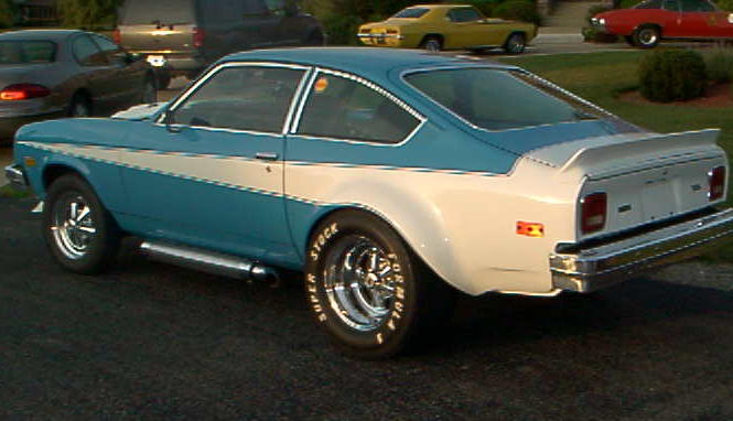

I'll have to measure the rear. It is a perfect fit with N50s and the Motion ZL1 flairs. I was confident that it was a Don Hardy Built rear. The trans mount as well as few other components on the car are also Don Hardy.
