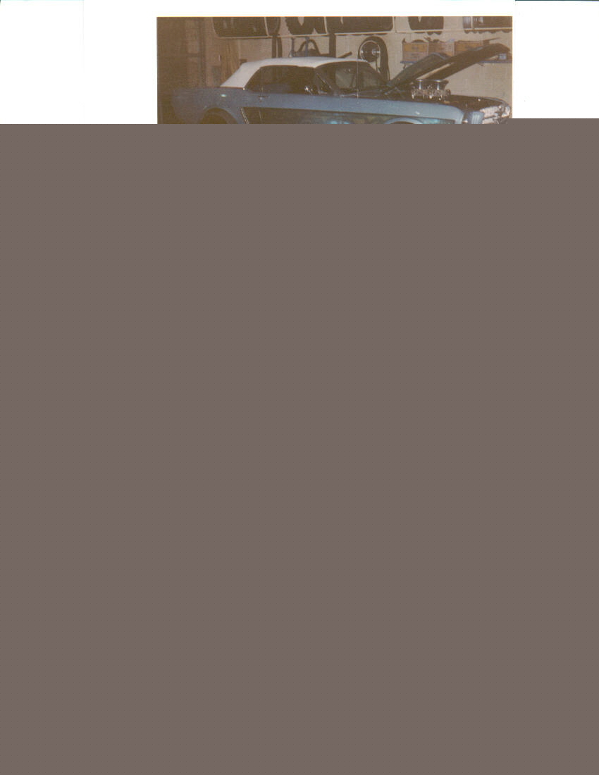

Chrome Plating? Check out my engine. Parts were plated by Paul's Chrome and Jon Wrights Custom Chrome with great results. They are about 1/2 to 3/4 higher than anyone else but you get what you pay for.
I would say Joel used chrome GM breathers or Mr. Gasket. Mr Gasket still makes their breathers and they are 100% like originals. You have to decide if you like the push in or twist on(my favorite)
Dave

Your right on the breathers---AC[ push-in] thru rubber grommet on valve cover and usually a turn type AC[ on the oil cap/valve cover]--unless you had to have MR.GASKET.----And PAULS CHROME--$$$---BUT beautiful!! [img]/ubbthreads/images/graemlins/burnout.gif[/img]
NICE engine!!!---how do you steer that thing???

How do I steer it-as in seeing around it? Car also has a 7" Grump lump hood scoop. I only drove the car 3-4 miles after I bought it but I did not have any problems seeing around the scoop.
Dave

Whitetop,
Do you have a picture of the car that engine is in----like to see photo if possible----still NICE engine!!!---JoeG
