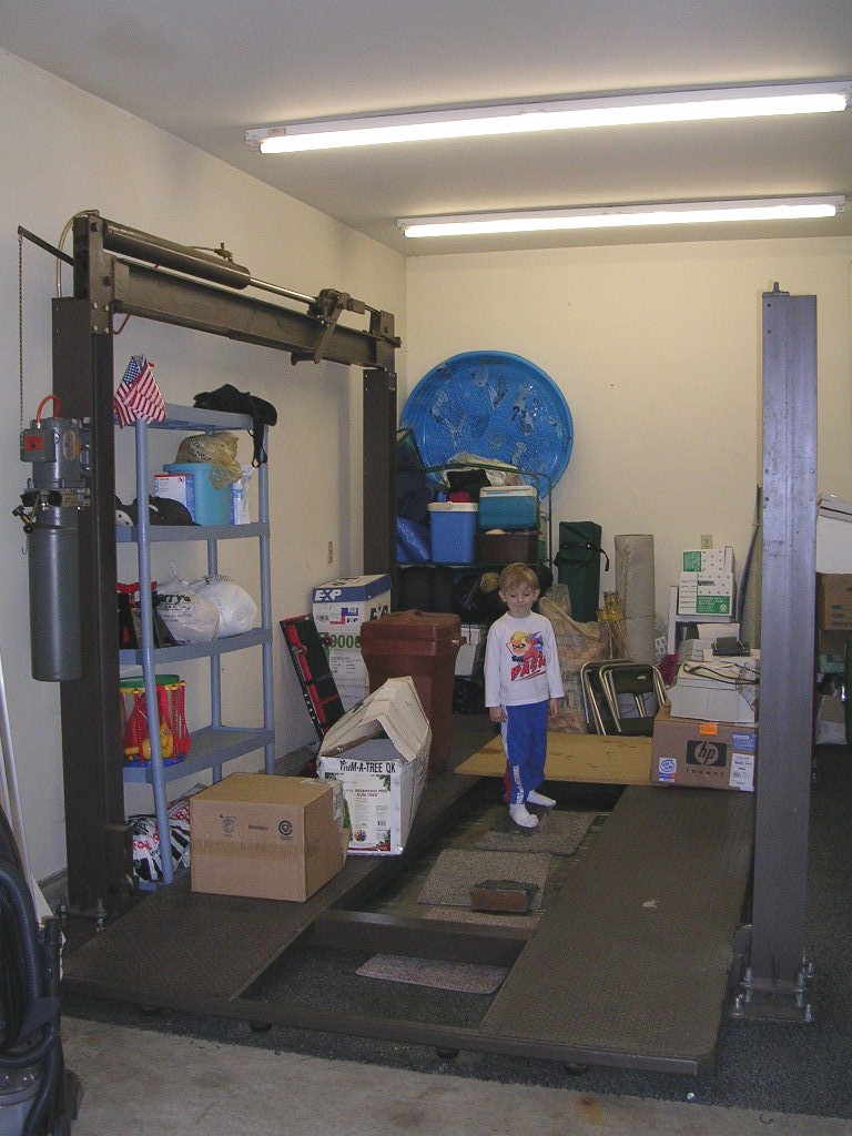

Due to limited garage space I am ready to add a car lift. The primary use will be for storage, but it will also make some projects easier to complete (like detailing the bottom of my 67 Camaro).
Which would be better, two-post or four-post? Anyone have a favorite brand / model? Should I avoid any brands? Is an electric lift preferred to an air lift?
Your opinions are appreciated!
-Seattle Sam
Attachments - The Supercar Registry 137913-lift2resized.jpg 137912-Lift1resized.jpg
