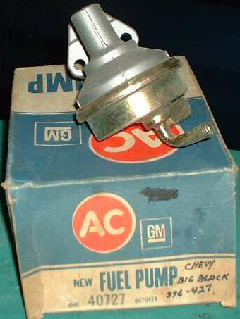

I pulled this fuel pump off my motor of my 1970 Nova SS 396/350 hp car during my restoration. I am trying to find out if this was the original fuel pump. I don't have any books to decode a fuel pump. If it is, does anybody know of a company that can restore it? This is the number on it: 159M4072 It has just the plain AC lettering on it.

The 62-70 Parts book lists the pump as:
<font color="red"> 70 Nova, Camaro (396), 70 Chevelle w/Sp. H/Per. (396, 454) 6470424 (type 40727) </font color>
Type is the AC number. So 159M4072 might be the date code and the first 4 digits of the type. I do not have anything on fuel pump date codes handy. This number was new for 1970.

Here is a pump someone was selling on ebay awhile back.
Nova Research Project at chevynova.org

Here is one found on ebay that looks to be a remanufactured or aftermarket.

If I recall correctly, 159 is the date code. Many people in the know have not determined the "M" and these letters vary all over the place from what I have seen. The rest of the number is correct but it is likely you cannot make out the last digit which should be a "7". It should read 159M40727 which is the correct stamping on a "727" pump. Double check the size of the AC stampings on the side.

Now I know why I posted this question on this web site. You guys are really sharp. I looked at the fuel pump again and behold there is a 7 at the end. You can just barely see it. The number is:159M40727. I think I figured out the code and the M. My transmission had the "M" code in it which was August. The 159 is probably the 15th day of August 1969. Makes sense. My engine was stamped T0820CTX which is August 20th. So the code probably is August 15, 1969. The AC lettering is about 1/2 inch long and about 1/4 inch high. What do you think? Original?? Any ideas who could restore it??
