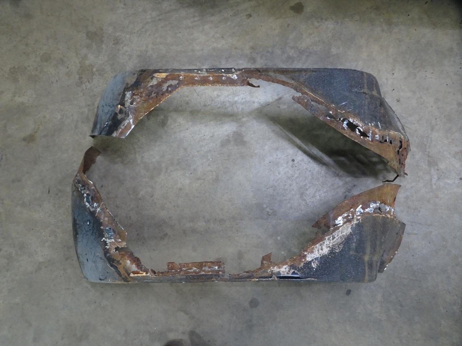

Today was take the floor out so I can work in the "trunk" to cut out the lower half of both inner wheelhouses and cut down the new repros to fit. Still a few hours to get them exactly how they need to be, but, again, they are very close to original appearance and fit.

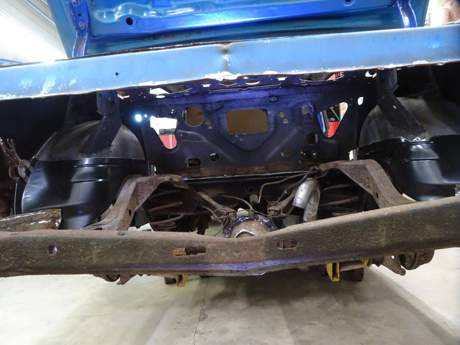

Hmmm... that is an old pic. I have the trunk floor welded in and the right q-panel off. Fitting the repro now and not very enthusiastic about the fit.... LOL
I, also, haven't done very well with taking pictures. I'll get some in the next couple days. Been spending time at my friend's shop, working on the Camaro. THAT is coming along nicely and will be all jammed and ready for paint in the next few weeks.
