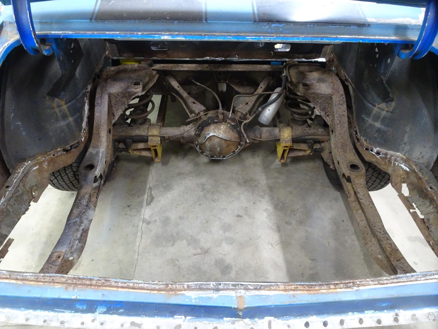

I didn't see any point of including pics with the previous novel, so here are a few. I've had the floor on pallet racking for 6 years and it was filthy, so I first vacuumed it and then gave it a sponge bath so I didn't have to look like pigpen when I worked on it...LOL I removed the original shifter seal hump and will be installing that on the new floor. Now I get to lay on the floor and weld it all together...Yay.

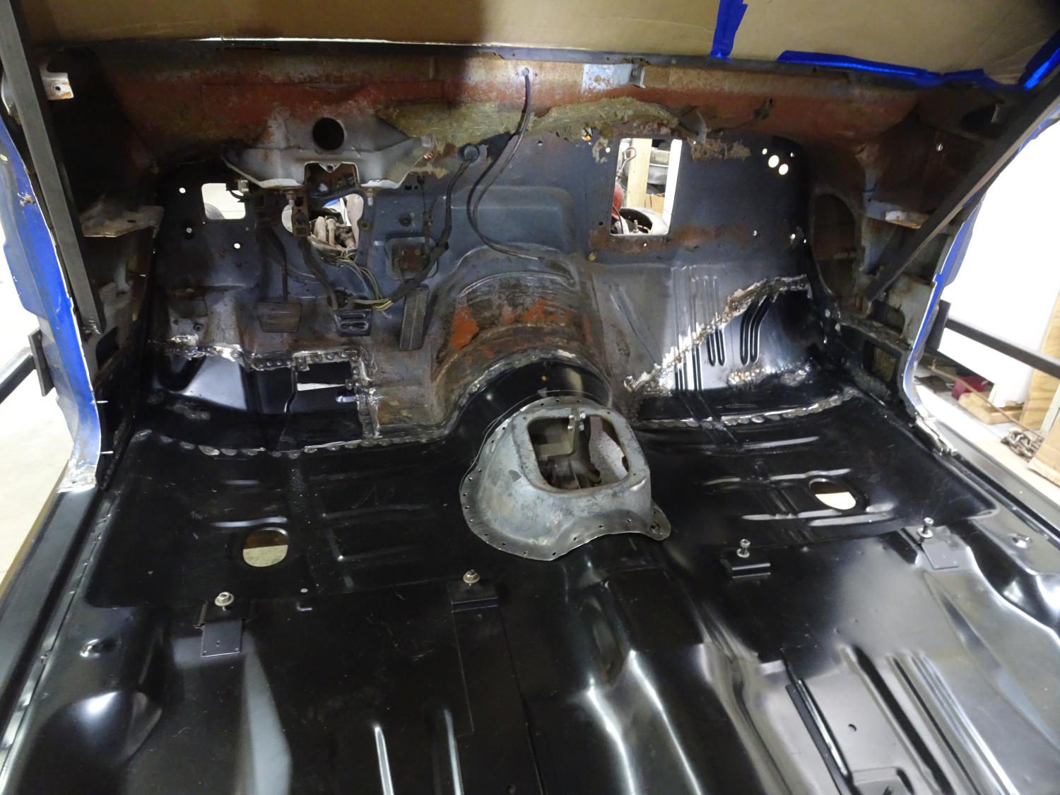

Since last post, I made a few, minor, adjustments to the pan and toe board patches and then proceeded to weld them in. The floor is where the floor stays now. It is not welded at the B pillar at all yet.

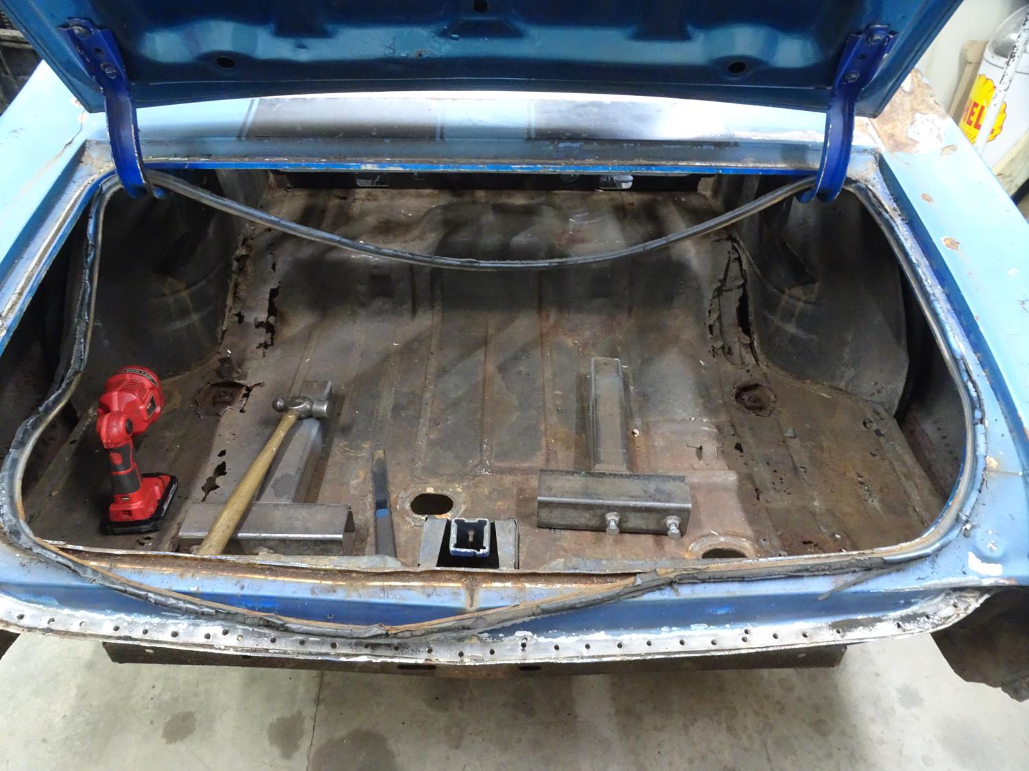

That was Friday/Saturday after Christmas. Monday I went after the trunk floor. I cut around what was left of the perimeter inside and drilled out the spot welds to the tail panel. I keep as much of the original parts intact to test fit the replacement against. It took a couple hours with my air chisel, stone grinding wheel and cut off disc to get it all cleaned up. I then slid the new floor in and it fits very nicely. There are, as expected, a few "adjustments' to get it where I want it, but it follows all the original weld locations quite well. The left front corner won't slide over the main pan, so it will need to be opened up a little.
See, there isn't anything special about this restoration stuff...a couple big pieces and a few support ones around them and BAM, we have a new floor... OK, it will be a few more days before it's actually a done deal and I move on to the next phase, but it looks damn good in there.
