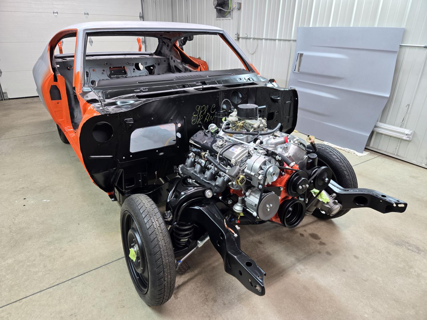

Dropped the body tonight. Its nice when all the holes line up perfectly. Center the body left to right and front to back. Really easy with this car. Xmas break I should start hanging sheetmetal to ready for car to paint in the early spring.
