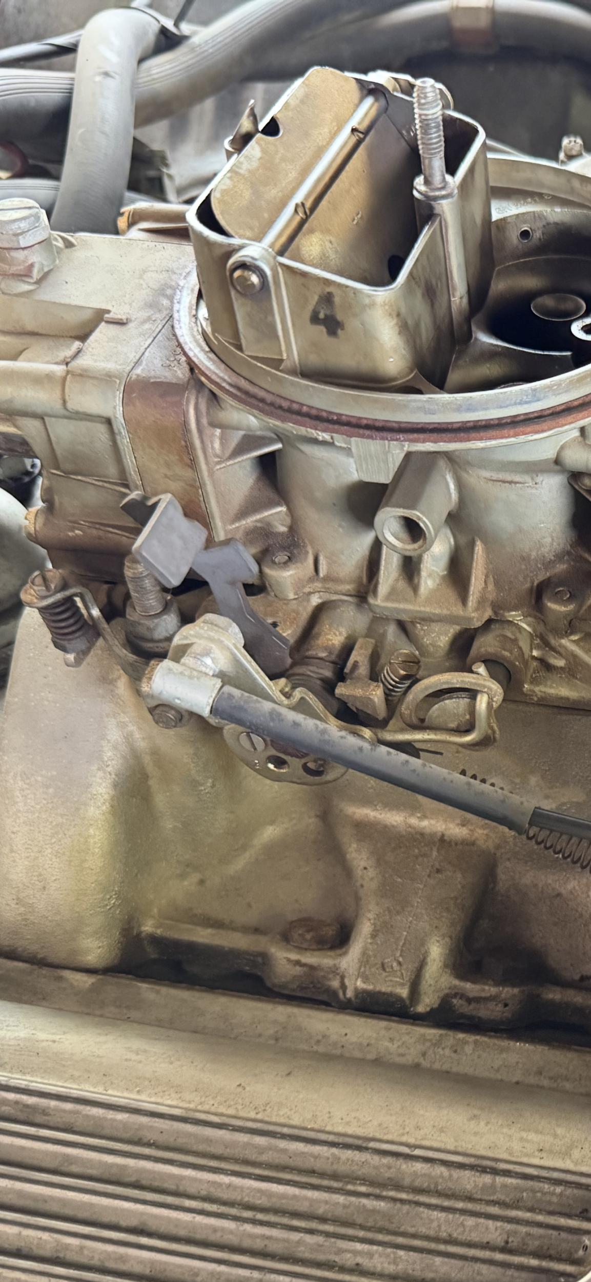

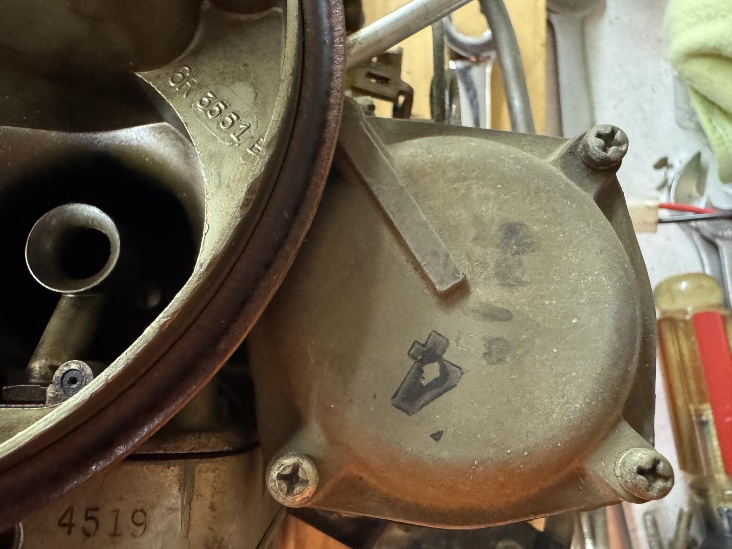

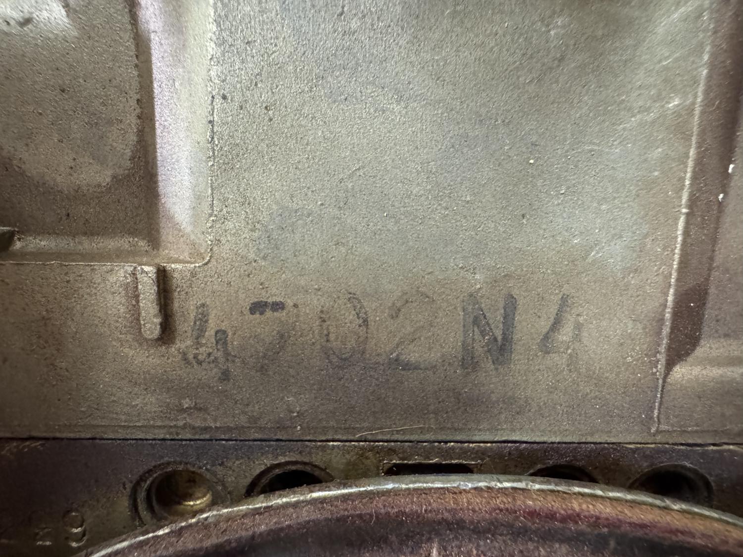

Does anyone have a survivor Holley that still has the "4053" ink stamp? Looking to create a stamp and need dimensions etc.
Ty, Doc.

This one is also a 1970 Z28 carburetor. Looks like there’s no rhyme or reason for how they were stamped as far as the placement of the stamp. Very random from carb to carb!
