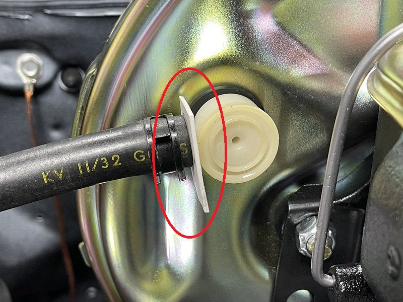

I "Think" the J50/J52 Comb booster check looks like this for ALL three years:
The AIM is silent (No PN Called out) since this part was supplied with the Delco Booster
We generally call it the "Three Dot" given the concentric rings and 3 molding raised circle "DOTS" on the face.
Ref Photo Lloyds 69Z (*Insanely hard to find in this cond.) [Disregard the Red circling of the tag]

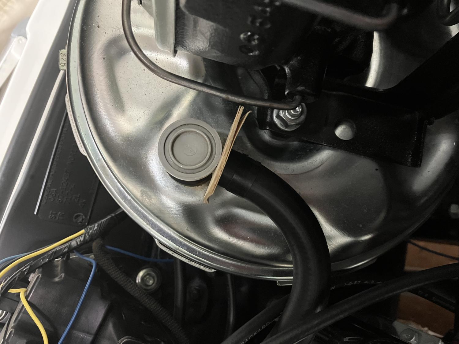

This is pic of mine. It’s light gray, on a 30 years old ASL restored 9204 booster. Is this the square edge clip your referring to?

Richard,
Yes, that is the clamps I am looking for.

The hose n clamp were on my car when I bought it in 95. Is my light gray plug in thing a repop?
