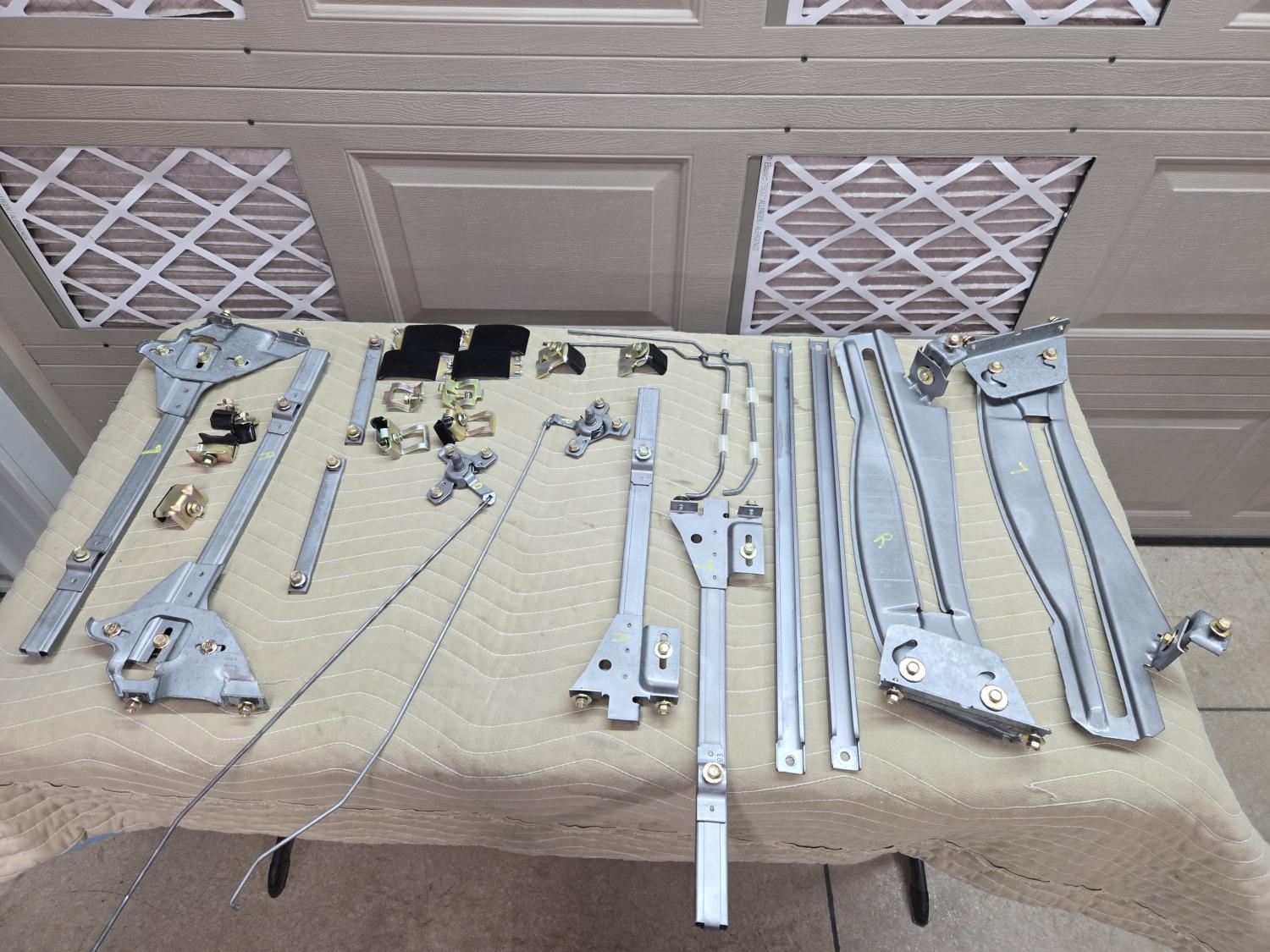

Default Window Reg, Tracks, etc
All the tracks, regulators, and misc hardware at get blasted and cleared, or blasted and re zinc plated. All the hardware im redoing in yellow chromate. Most of the track and regulators where in nice shape. All the rubbing parts get new felt material glued.
