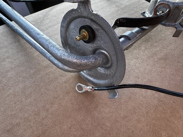

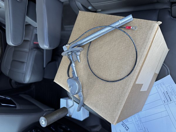

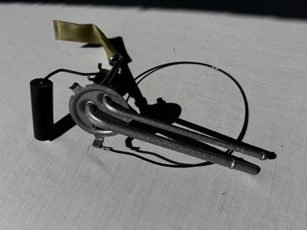

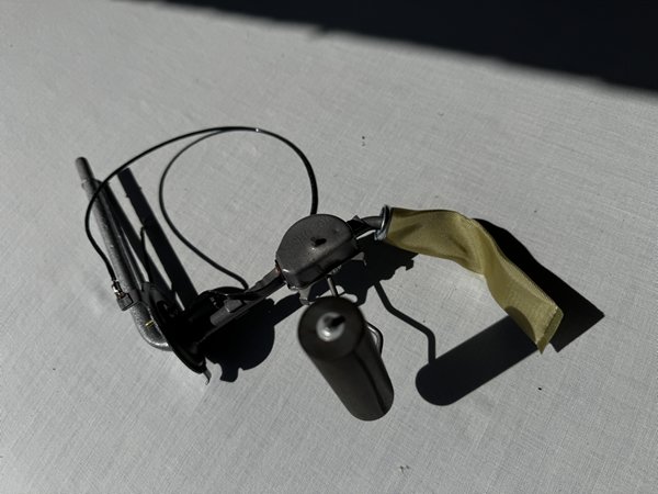

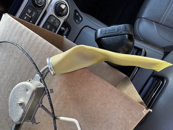

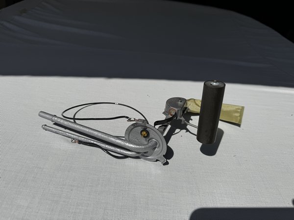

Picked up the restored gas tank sending unit last week. Will not have a chance to install it as I'm putting the Chevelle away for the season today.
Looks like they sandblast it and apply a clear coating rather than plating it. Took about 3 months to get it done.
