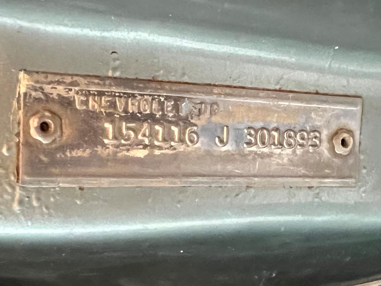

i joined because i recently purchased an 1966 L72 biscayne.
im jumping on this thread because i see that the discussion is about a 1966 biscayne L72....i hope thats right.
anyway, there are a few things that i could use help with, so i was wondering if anyone could help me.

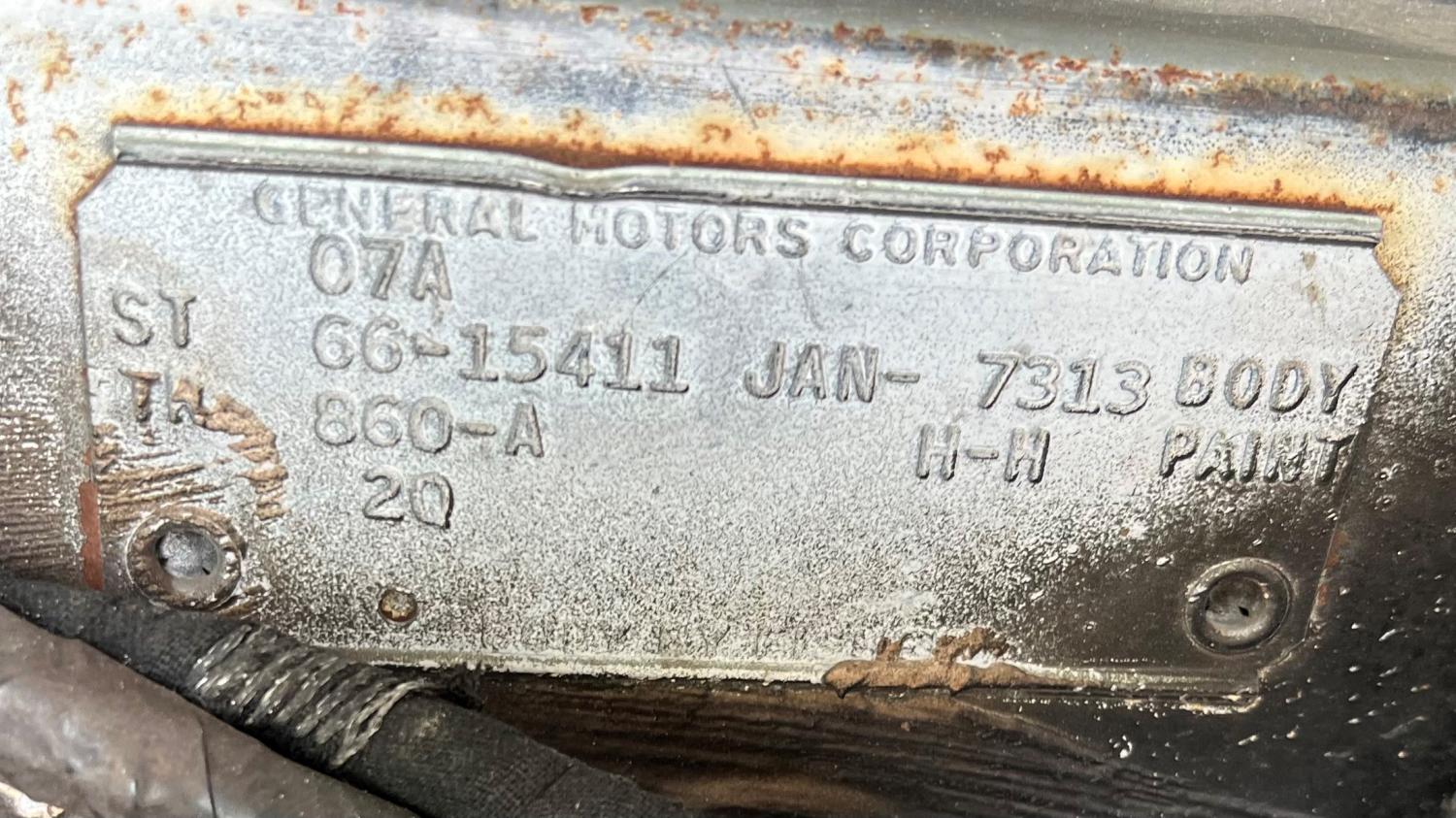

first, i'm pretty sure the car is real, based on the vin, cowl tag and numbers from the trans and rear, so i'd like to register it, if not already in the registry (i guess the follow up is whether or not this car shows up already).

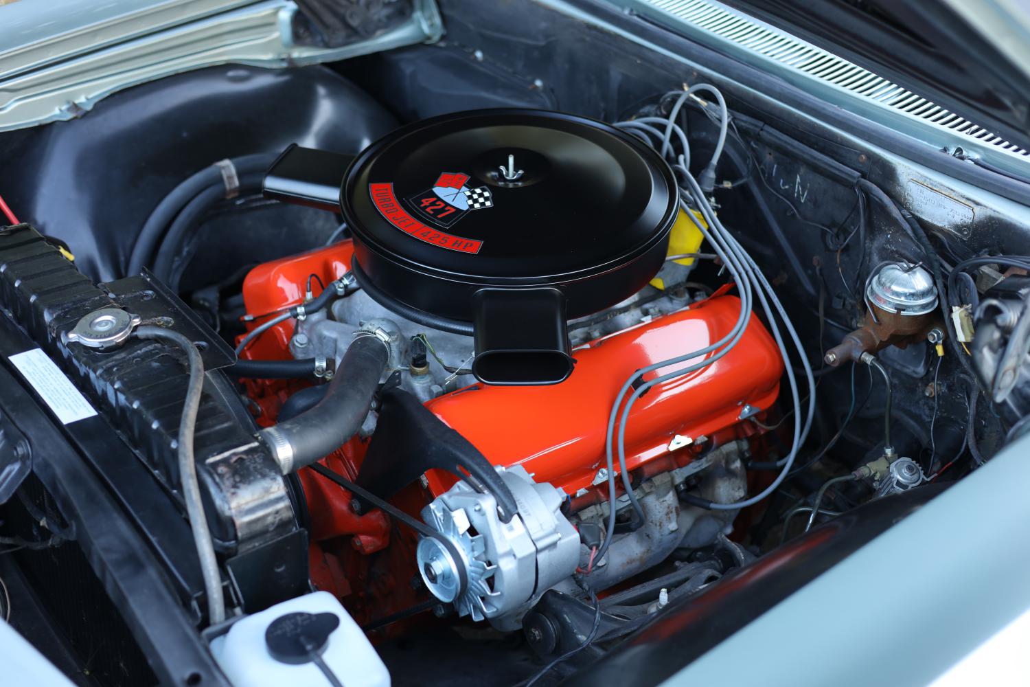

the motor is not the original as it was said to have been blown in '68 and replaced with a chevy crate engine (i'm looking into the dates and numbers on that but at first glance appears to corroborate in that it is a 512 block)
it is missing some interior things like a drivers visor and dome light but what is odd to me is that it doesnt have a factory tach, so not sure what happened there.
also the exhaust manifolds arent correct and it is missing the idler pulley assembly.

1. Unlike the prior poster in this thread 'kenbrogan', your car's VIN indicates it was originally produced with an 8 cylinder engine, so that's a good start.

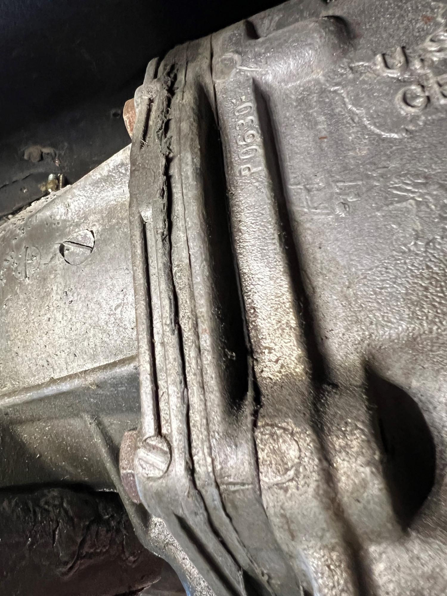

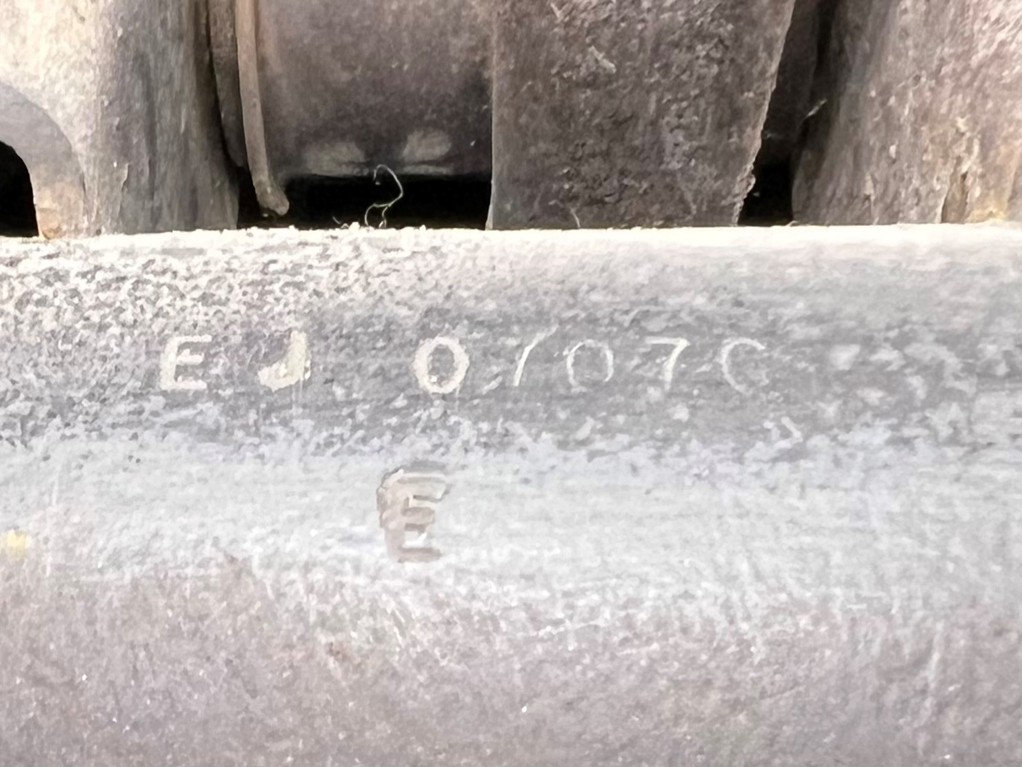

2. Rear axle and trans pictures you have posted have good assembly dates that line up with your car's scheduled production date (from the Trim Tag) of 07A (first week of July). The EJ code on the rear axle indicates it was originally equipped with a 4.88 positraction differential, and had metallic brakes....both very strong indications of a car ordered with drag racing in mind. I believe the transmission should have a partial VIN stamping also, but it could be up on the top of the transmission where it would be extremely difficult to see with the trans still in the car.

.......also a q code in group 2 on the trim tag, so it's a 4 speed from factory. Some say that indicates a M21, but not positive if that's conclusive. Love the car!!

when i did my research before i purchased, i thought the same.
the 2Q means an M21 and the fact that the rear gear is more than 3:31 (in this case 4:88) meant that it can only be a real L72 because you couldn't get that gear otherwise.

of course, all of that could be faked but like Bill Prichard said, the date codes on the motor and trans seem right....
That would be trans and rear axle....

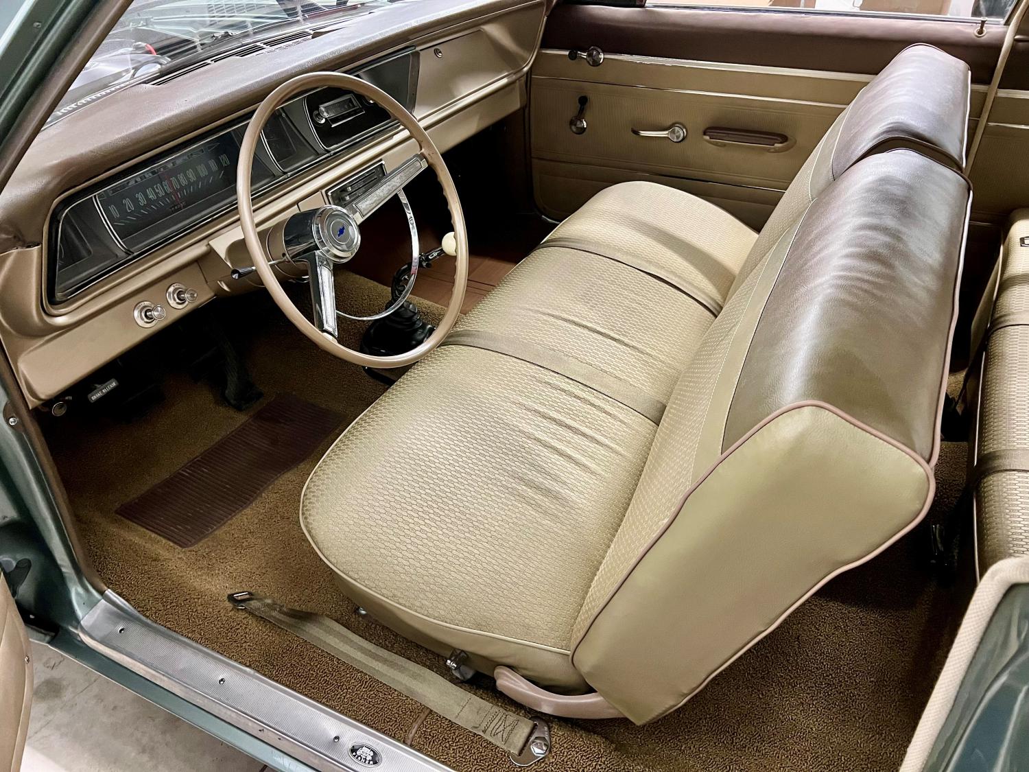

Hard to see but looks like it does have a tach. When you ordered a 4-spd with 325, 390 or 425 HP engine it included the tachometer. If so is the tack a 7K tach with a 6K red line?
Also as stated, he M21 was available only with the L72 motor. Also the 4.10 through 4.88 rear axle ratios were only available with the L72

Paul, i heard it both ways, that it came automatically, or you could option the tach, but in this case, it is a clock.
and i also thought the M21 was only available with the L72 as well as the rear gear upgrade, of which i have both and the 2Q code backs that up
