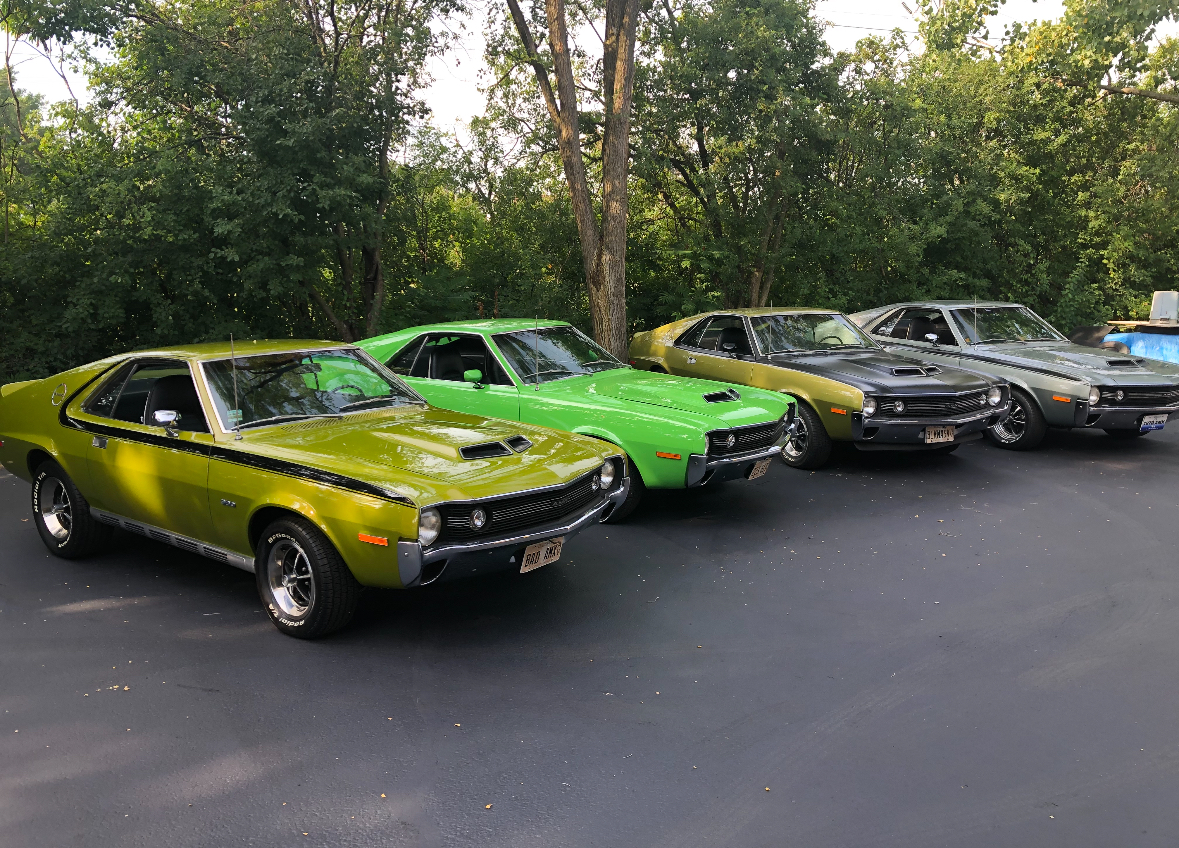

A bud sent me this, looks like your color there

That Golden Lime/Shadow Mask 70 AMX is badass and something I’d eventually like to find/own.
