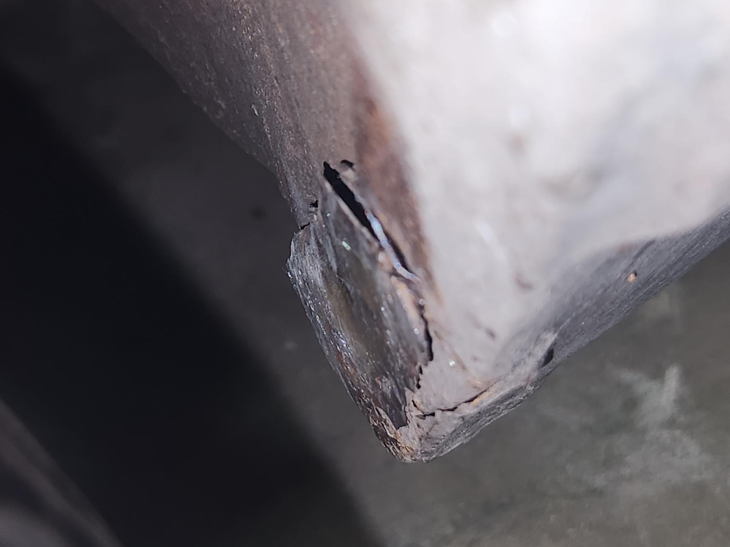

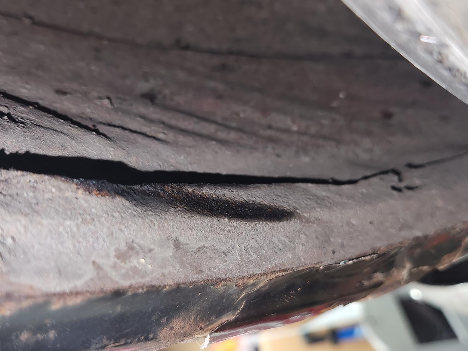

Turns out the front left wheel wasn't rubbing on rust but an old attempt at a fiberglass repair. The tire also may have rubbed on the fenderwhell just a bit under full compression of the suspension. I may run just enough wheel spacer to clear the calipers and I believe that will cure the problem as I'm running 3/8" spacers now. It happens rarely so it doesn't bother me at the moment.

As much as I really like the F70-15 on this car, I think the E70-15's is a perfect size tire. The ~1/4" diameter difference would be all it needs not to rub at all. The Firestone E70-15s I had on the front with the Cragars never rubbed on rear of the fenderwell like these ones occasionally do. It is more noticable in reverse when backing out and making a sharp turn.
