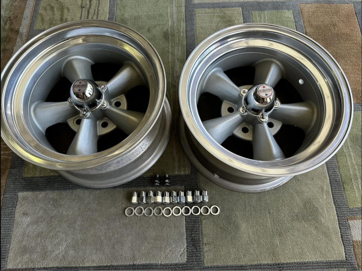

Hello, I’m looking at a set of Original Appliance Torq Thrust D Crows Feet wheels finished by Eric Vaughn. I’m looking to use them on the rear of my 69 L-78 Camaro. The size is 4 3/4 Bolt pattern with a 3 3/4 backspace. Seller says they are for Chevy but not sure about fitting a 1969 Camaro. My Camaro does NOT have disc brakes. Also what would be a fair price on these 15X8 restored Appliance wheels? Any info is much appreciated. Thank you for your time in advance.

Those may work on the back, but think you would have trouble on the front. They will stick out toward the outer fender lip 1.75 inches closer to the lip than a YH rally wheel.
To keep the wheel centered in the wheel well, using an 8 inch wheel, you would want 4.75 BS. That would keep the offset the same.
YH is 4.25 BS on a 15x7.
The only way to know for certain would be put them on, or find someone who has the same offset 8 inch wheel on a Camaro.

Thank you Sir for the reply....Looking at them for the Back. Looking at a set of 15X6 from another member for the front. So the 4 3/4 bolt pattern they have is not an issue?
4.75 is correct for Chevy from that time period. 4.5 would be Ford and most Mopar back in the day.
I thought that back spacing sounded familiar. While I was down at my shop, I measured backspacing on the AZ wheels from my 1970 LT-1.
Same as the ones you are looking at (3 3/4). They are also an 8 inch wide wheel. So, if you can find a friend with a C3 Corvette, you could try the wheels on the back of your Camaro.
I am thinking those were likely made specifically for C3. Doesn't mean they won't fit your car.
