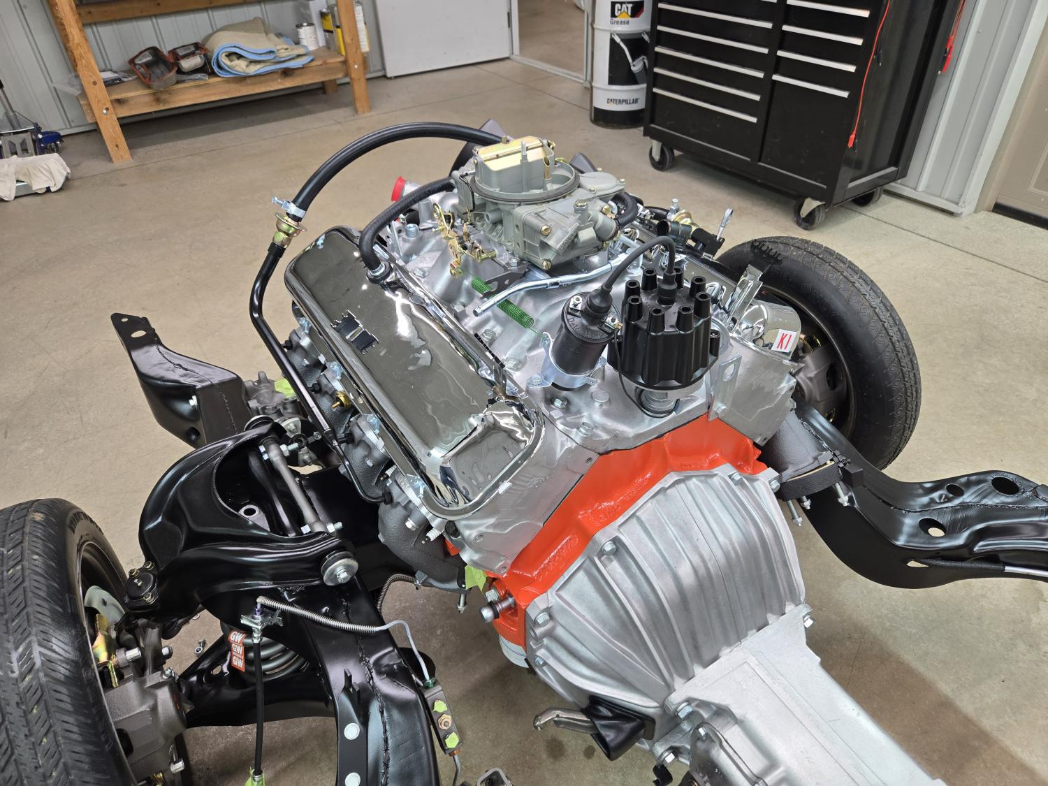

Default Engine Detail Work, and Smog
These later year cars seem to have alot of extra work in the restoration to work on items like smog. I was able to restore an original diverter valve which included phosphating the air intake, plating the diverter valve cover, and giving it the GH, and giving a chromate coating to the remainder of the valve. Came out perfect!
Rest of the engine doesnt look to bad either. Even thru in a KI sticker on the valve cover for fun.
