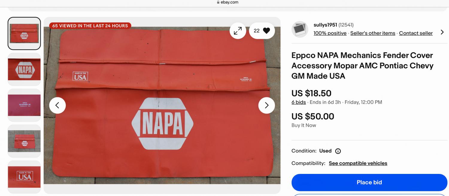

Tim,
You probably have a case of these, but what a cool wall art this would be.
