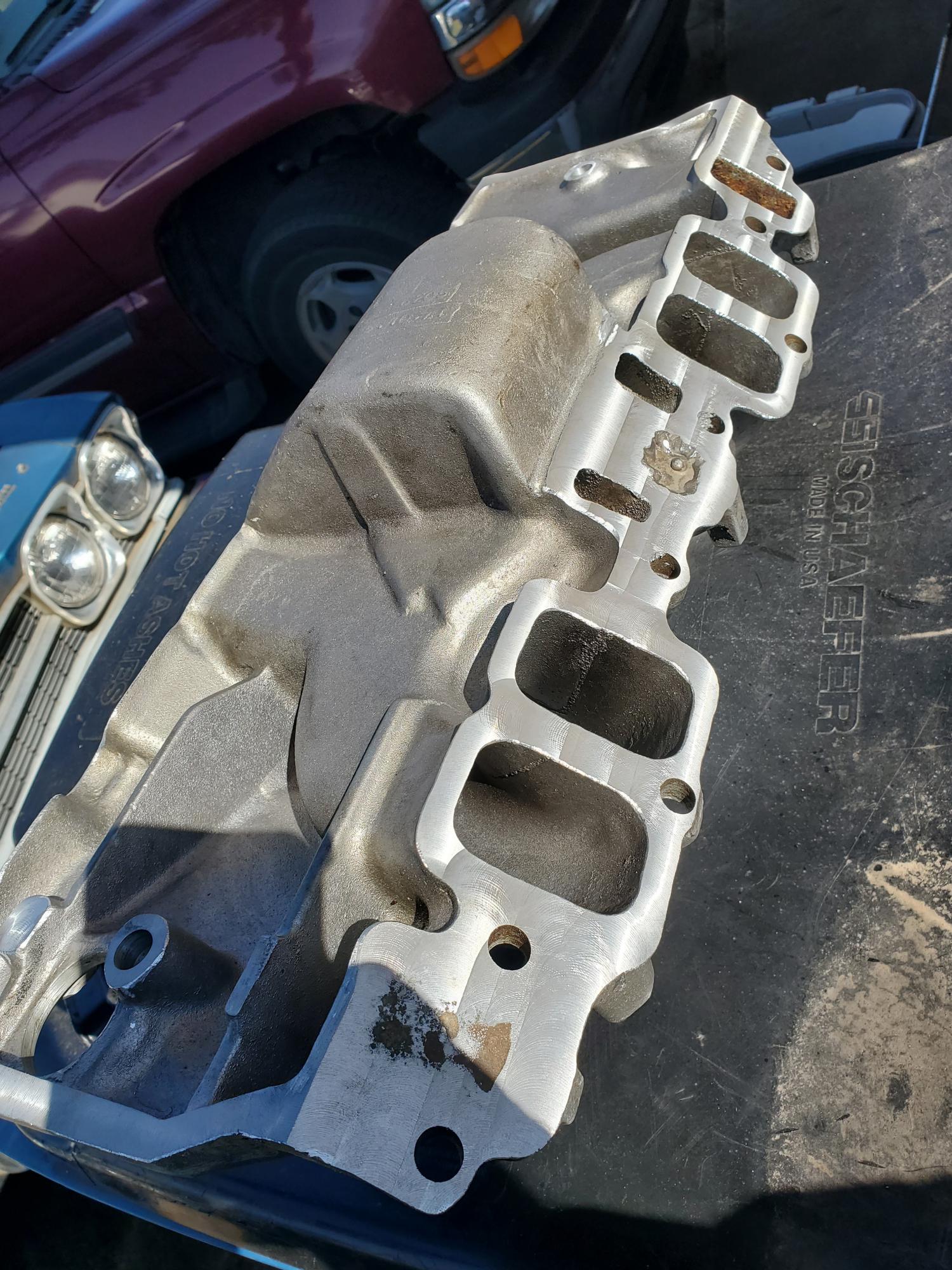

so these 842 heads are about done they were milled enough intake needed to be milled down .060" and .125" on the ends 3 trips to machine shop anyway its fitting much better, someone did me a favor and had welded up the crossover, glad it wasn't the date that should be on the car

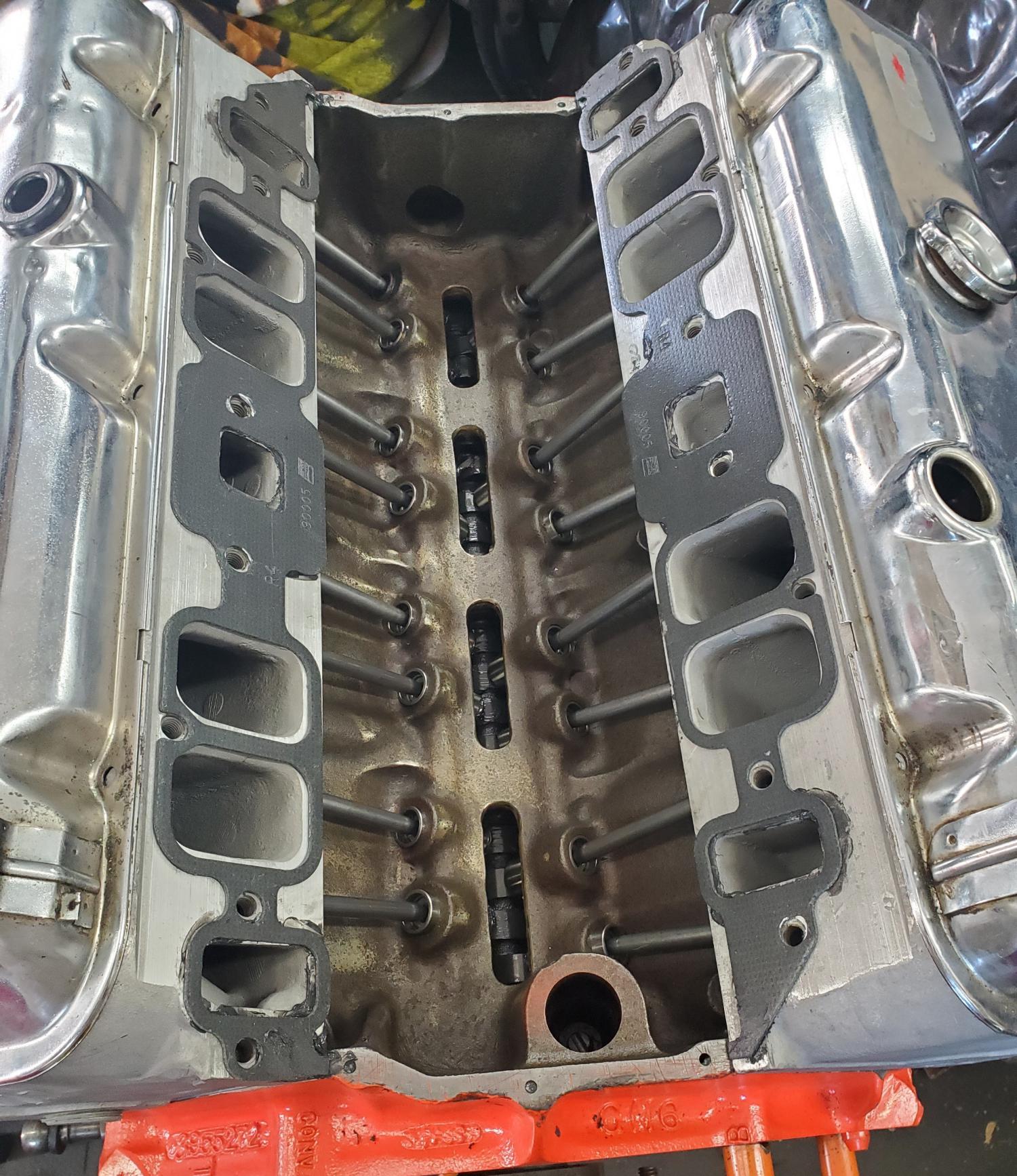

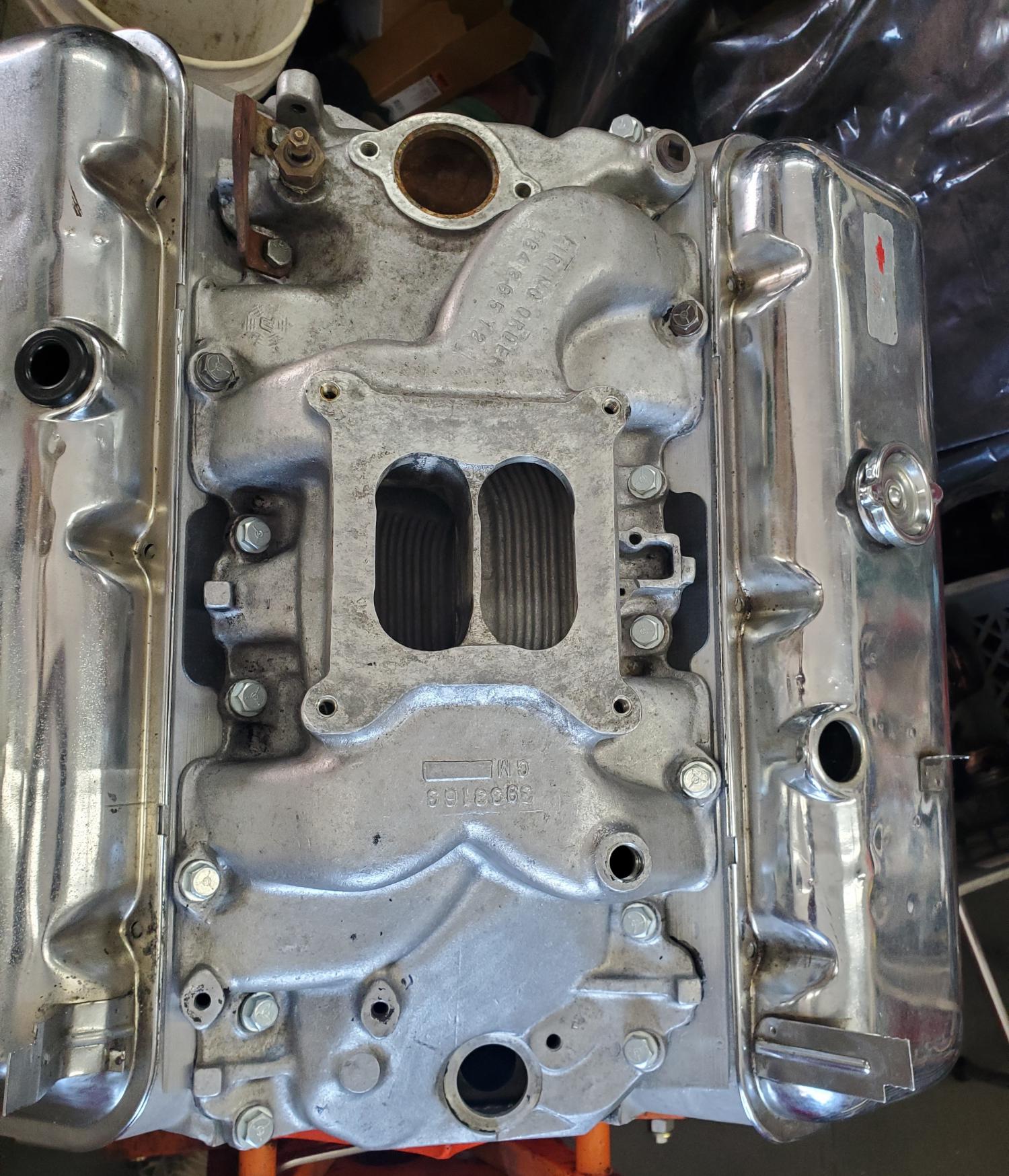

well, I'm glad that's finally done! now to find a weekend to do the swap the nice thing about a beater is this will only see limited nighttime use its next caretaker can make it pretty.

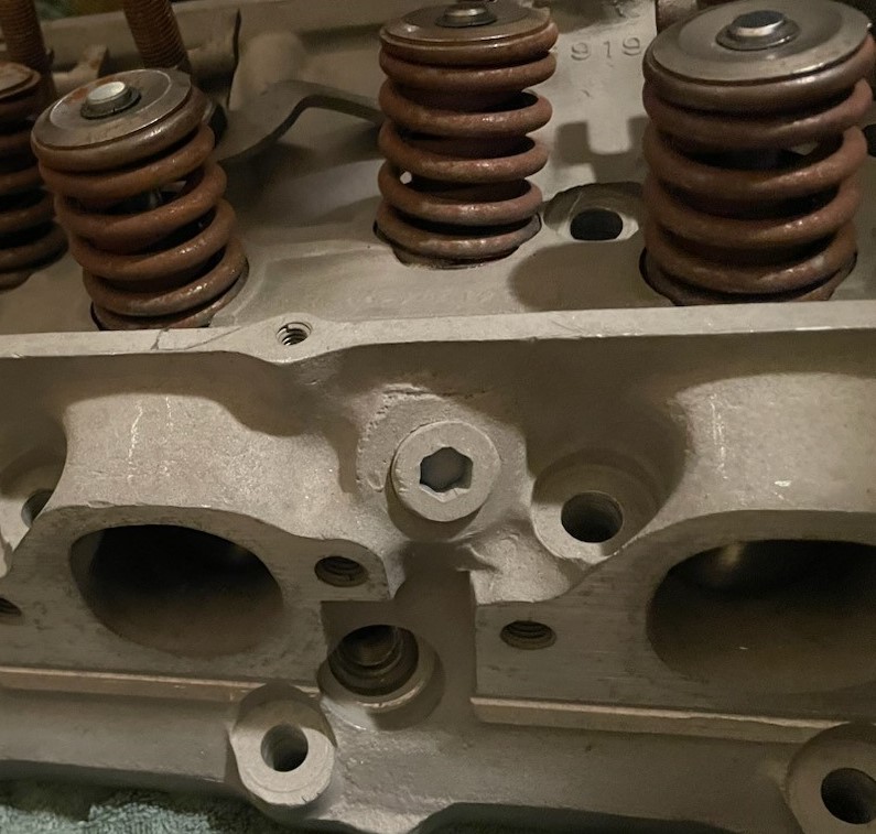

the drivers head has a plug where temp sender should be and it looks like its been in there a long time and I don't want to break a tool off trying to remove it - any suggestions?

That's the same 90005 FelPro gaskets that I always use. I love those gaskets. Be careful with those valve springs. Rust on a spring can cause it to fail.

those were on heads when bought and I trashed them, just best pic showing the plug I want out headshop installed outers of comp duals for break in
