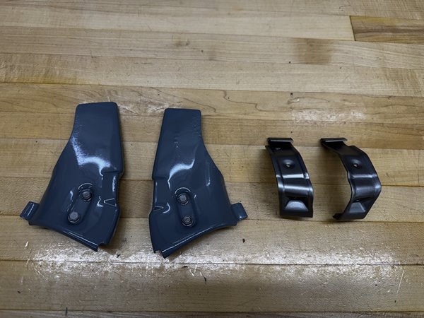

Tracked down some original bench seat trim brackets - as my interior guy said the reproduction ones weren't right when he was doing the seats and couldn't install the trim as a result. The originals do look slightly different so hopefully they should work. Sandblasted them and got them painted correctly so they are ready to go - I have an appointment for first week of April to get that done.

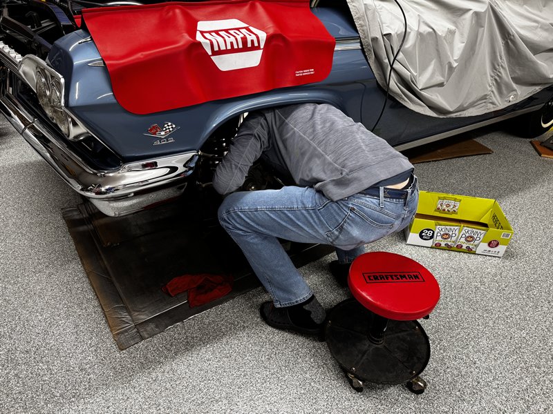

Made some more progress today......decided to dive in full bore on the drum brake conversion.
Jacob decided to come home for a visit and he didn't get any work assignments today so he was able to help a bunch. Dad would be over the moon ecstatic knowing his grandson was helping turn wrenches on this project.
We were able to get both disc assemblies off along with the requisite bracketry and related. Also took off most of the brake lines (I ordered all new stuff) with two exceptions. Didn't take the front crossmember line off as I need to spend some time strategizing how to do that with limited access to the fittings on the driver's side - and I still have some challenges with the front to rear line (a la the Chevelle project a few years back......). Whoever installed the disc conversion kit did some bubba engineering to the front to rear line. I have the new line here. I was able to get the front half (it was sectioned into 3 pieces vs. 1 and crossed over the transmission to go from the passenger side to the drivers side ) of the old line removed but need a fresh mind to figure out how to get the rest of the rear section out and install the new one piece line. I haven't had to cut anything yet and I think it can be done - just not today......
I will need to spend some time cleaning things up before any reassembly (30 year old restoration showing its age) but was able to mock up the driver's side backing plate assembly to make sure everything lines up - and it does. So once I figure out the brake line challenges it will hopefully come back together reasonably quickly.
If anyone needs a compete and good functioning front disc brake conversion kit I will be listing it for sale soon.

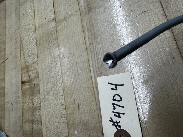

Spent some time last night in the garage and was able to get the old front to rear brake line out. Went to install the new line and saw the front end flare was boogered up pretty good so that ended that project for the night. Supplier sending a new one out today.

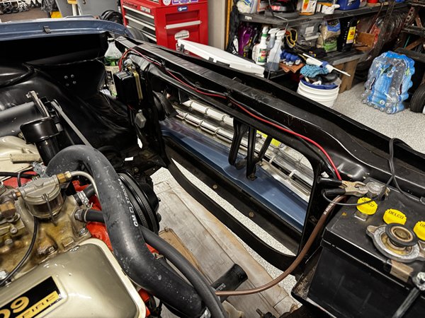

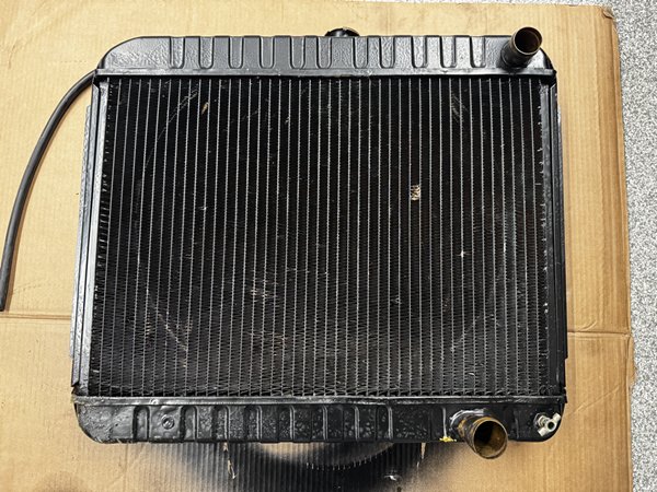

I dug a little deeper into the project and took the radiator shroud and radiator out. I will have the shroud re-painted and I think I'm going to have the radiator re-cored as it has several spots were the fins are bashed in pretty well over the years.
I ordered a few more small parts yesterday and also installed a new set of valve cover decals and re-installed the opti-kleen decal that had come off.
One of the frustrating things I am finding the deeper I dig into this car is the previous restorer used a lot of generic hardware store fasteners - so I am trying to source and replace those with assembly line pieces as I come across them which is a whole other project in itself.
Last week I picked up the hub assemblies and now those are ready to bolt on.
Tonight I will install the new front crossmember brake line, distribution blocks, and hoses which should wrap up that portion of the project. Then I can get the front drum and hub assemblies installed and get brake fluid back in the system and bled.
