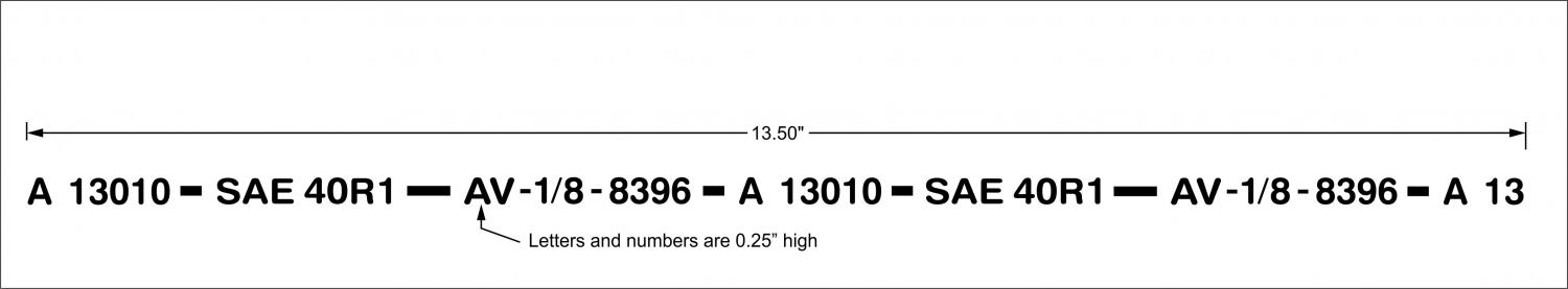

Here is the date code scheme for brake hoses:
Date code is B 11 03 0 which is: March 11, 1970 second shift of the form:
Shift(letter 2nd=B), day of month(2 digits = 11), month (2 digits = 03), and last number of year (1970=0)
