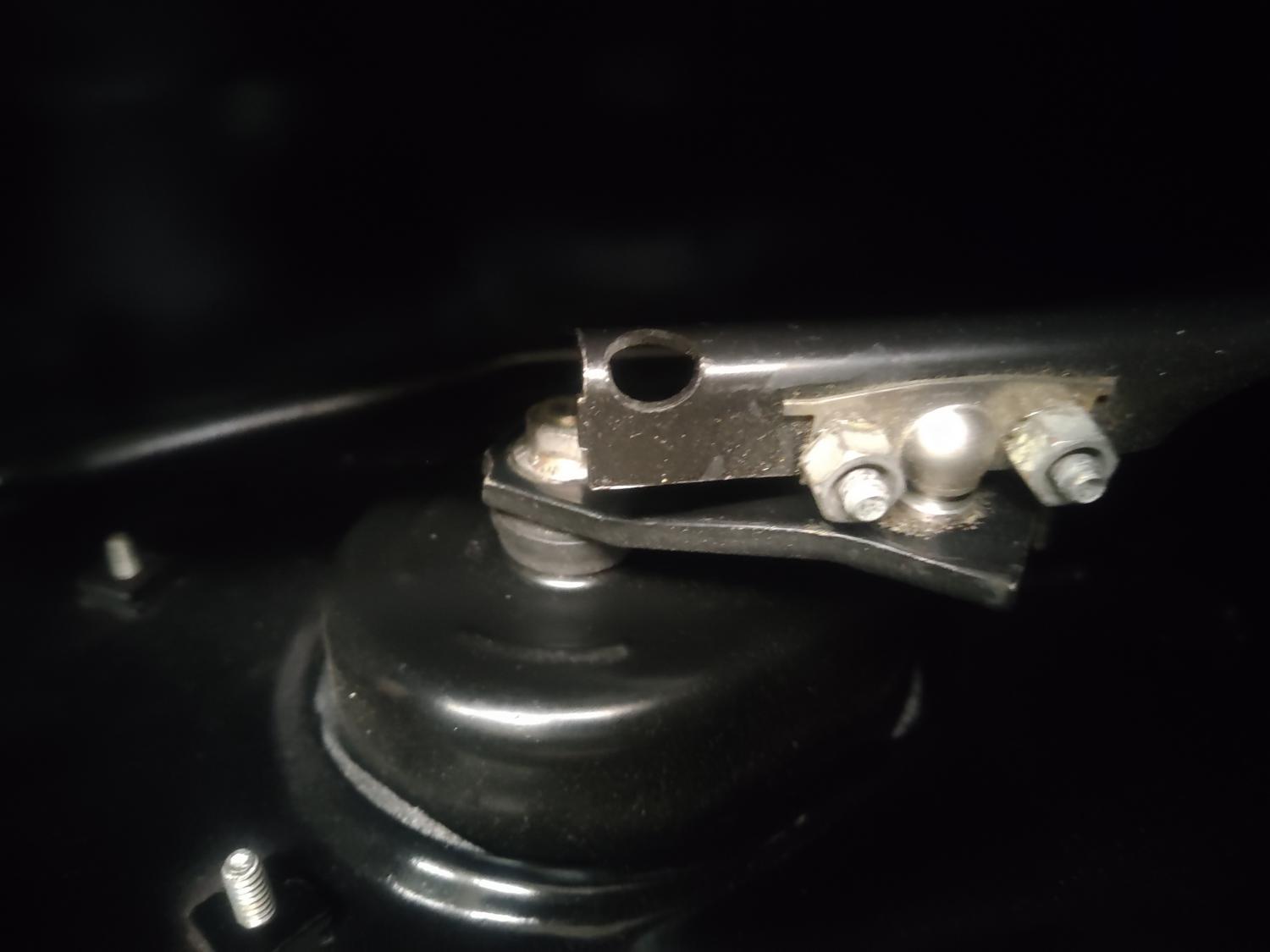

Beautiful job on the wiper motor. Just took a couple pics of mine, which is original to the car. Appears my non depressed park motor uses a lesser offset arm. Can't get a pic of the stamping if any is there, but the distance between pivots, center to center is roughly 2 inches.
Appreciate that. I have the correct one, which was the one I got with the car. I have a new question, the plates that sandwhich the wiper arm ball are yours original? Was your car Baltimore built? Mine were copper coated.

Not really sure if these were copper coated or not, possibly I cleaned them too well? The car is a KC Leeds car.
