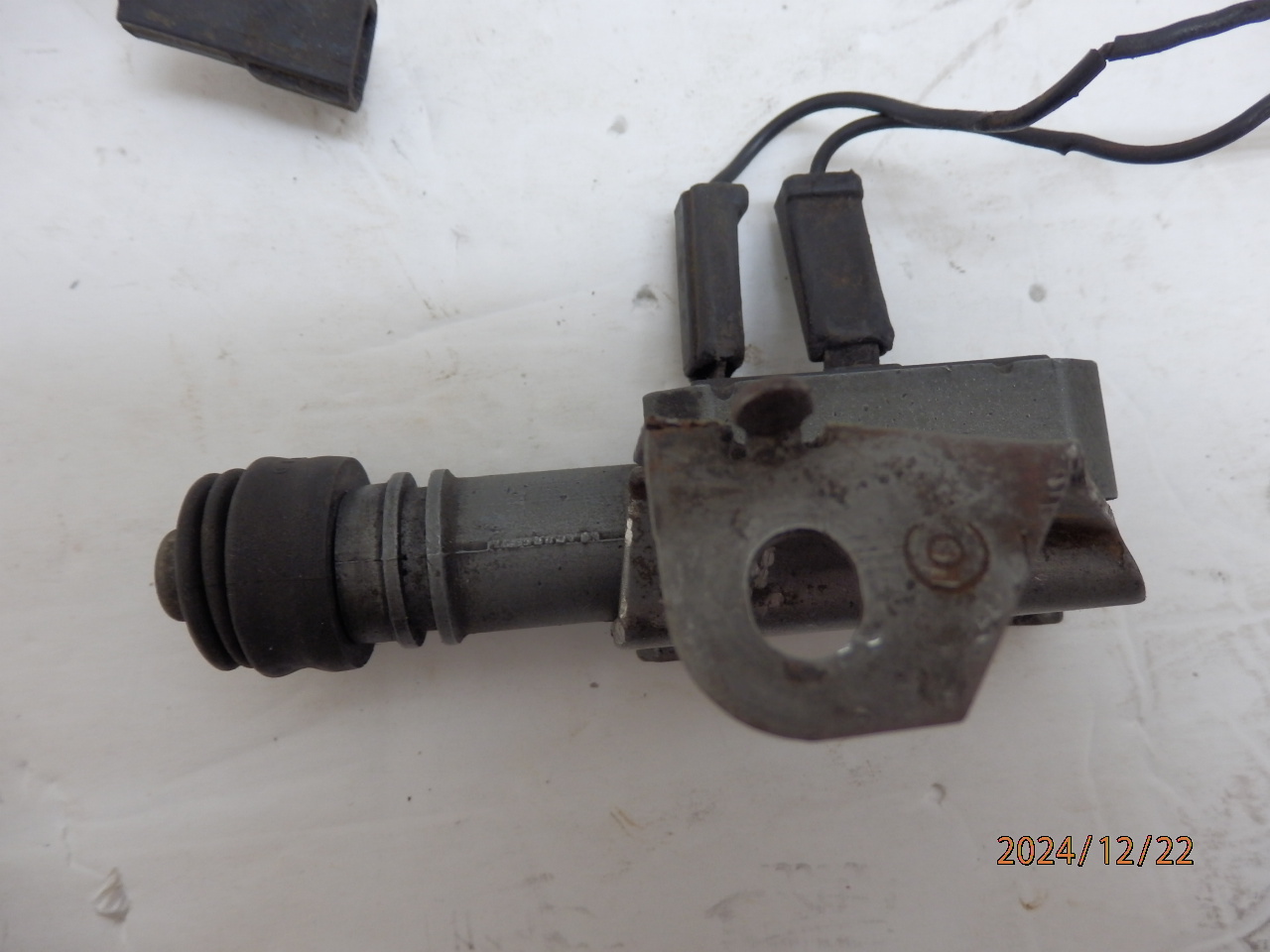

I am sure someone on here knows what this switch is for.
Attachments - The Supercar Registry PC220012.jpeg PC220011.jpeg PC220010.jpeg PC220009.jpeg

Transmission kick down for a th400. My 1969 Camaro ss396 has one of those switches. Goes on the LH side of the carb...Joe

I was told this switch is for a quadrajet, the bracket has one hole & a tab and the Holley bracket has two holes & a tab. I will post it for sale if anyone has interest.

A quadrajet carb is far more common than a Holley, L34, L35, LS5 and most the Pontiac and Buick performance engines were topped with them. I'm sure it would be a desirable part if it interchanges with them all.
