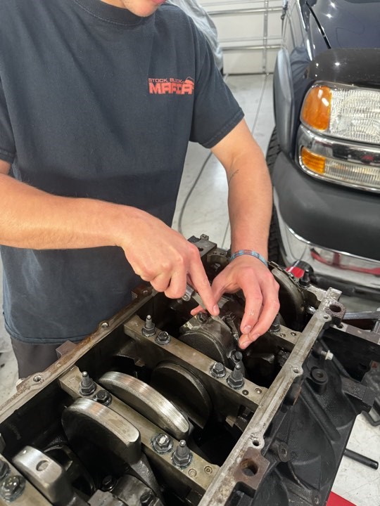

Next up rods and pistons ............
Along with checking Rod side clearance.

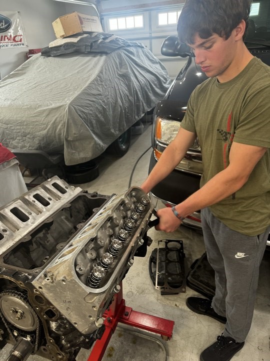

Time to add some heads . We used a Cometic .045 thick MLS gasket on this build. A OEM head gasket would have been cheaper, as these are overkill, but I wanted to set the quench at .040" since the pistons sit out of the hole .005", and there are no GM gaskets that thin.

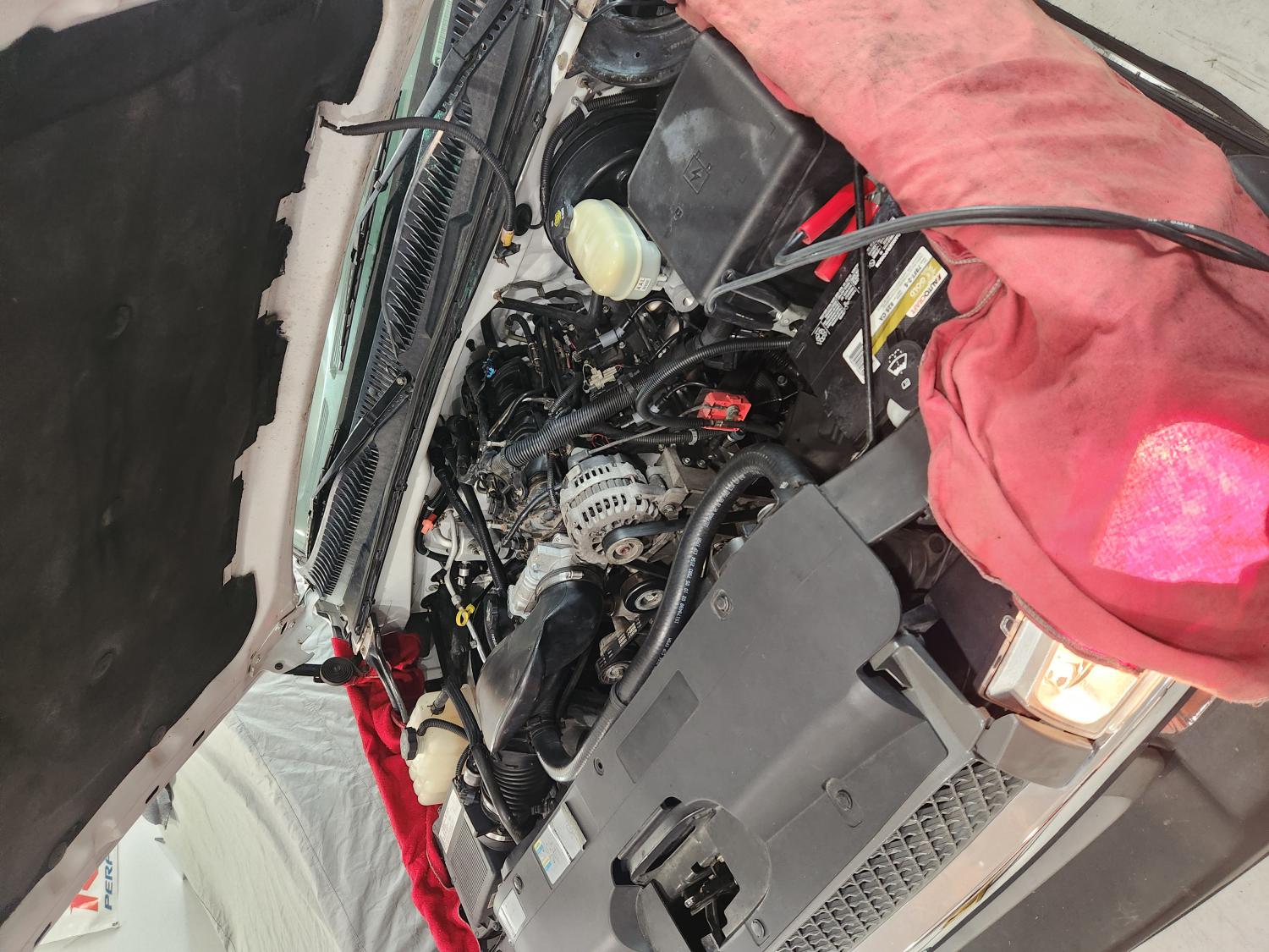

Cool
Engine back in a finishing up a few odd and ends ...
Added a later model L96 truck intake and 50lb flex injectors in case we wanted to go with E85 fuel down the road .
We also ended up adding a Circle D 3200 stall speed and some 1-3/4 ; headers, Y pipe w catalytic converter delete pipe . We also used on of my Borla mufflers for some added airflow and louder HOT ROD sound of course .
Doesn't look like 500+ hp now does it

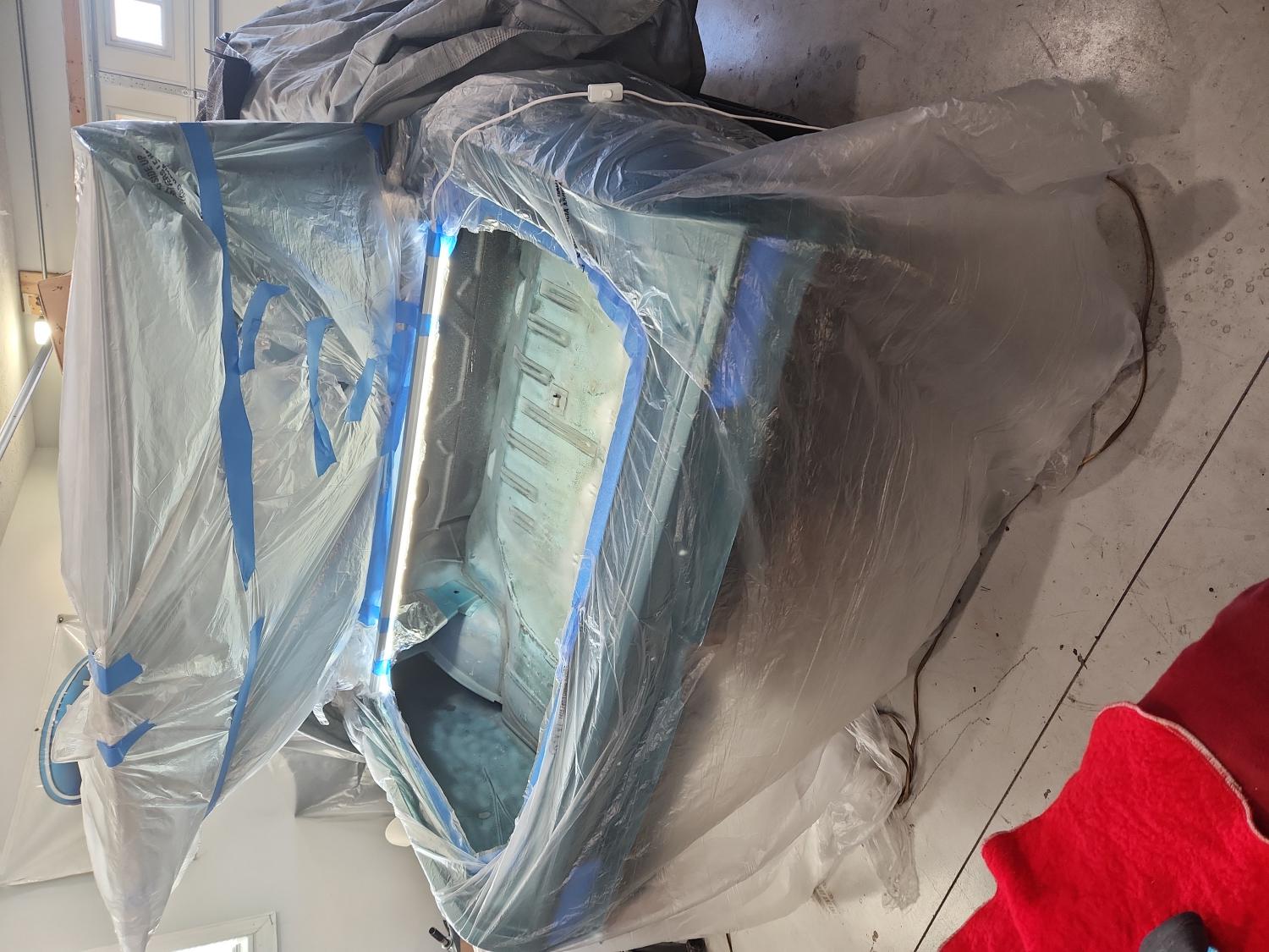

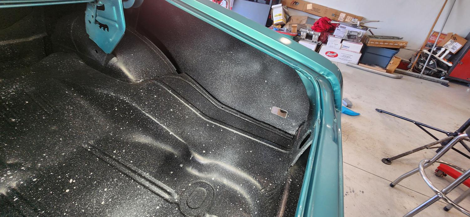

So finally was able to get the trunk detailing done .
Added some dark base color . The pics look glossy and sort of Black in color, but it looks much flatter and more Grey when fully dried .
I had purchased some trunk splatter paint from one of the big resto shops for use in a spray gun , but it just would flow right no matter how large tip I used .
I then experimented trying to add the splatter look.

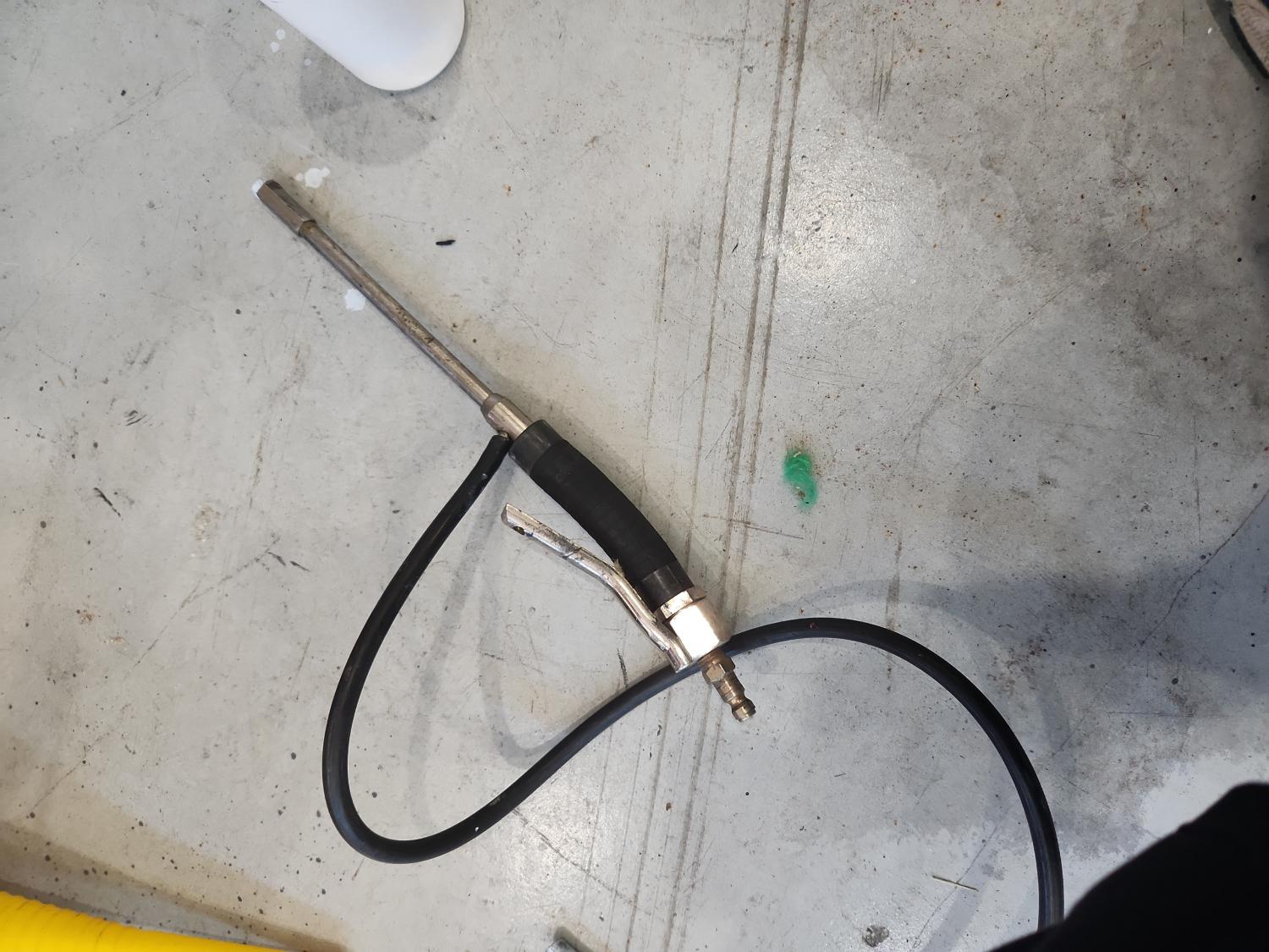

Used this old siphon style wand gun at very low psi ( 5-7 psi) we used for cleaning out heater ducting at the dealership I worked at .
Ended up spraying some epoxy paint from a spray can into a plastic cup and addingsome reducer to thin it out .
The final trick was to HEAVILY over reduce the paint so it flowed out to mimic the factory
spotting style.
Of course I figured it out as I went along so the look I was trying to achieve got better towards the end . But the finished product will work for a non concourse build and honestly back then who knows how well the cars were done from one to the other
