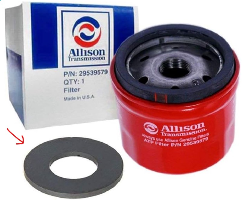

Yes, to both Transynd and Baldwin Filters. Make sure there is a magnet on top of the spin on filter. I use same fluid and filter in my 05 LLY Duramax. The GMT800 platform is one of the best trucks GM ever made. I love mine. Seats in them are almost like a lazy-boy recliner! Enjoy the truck!
