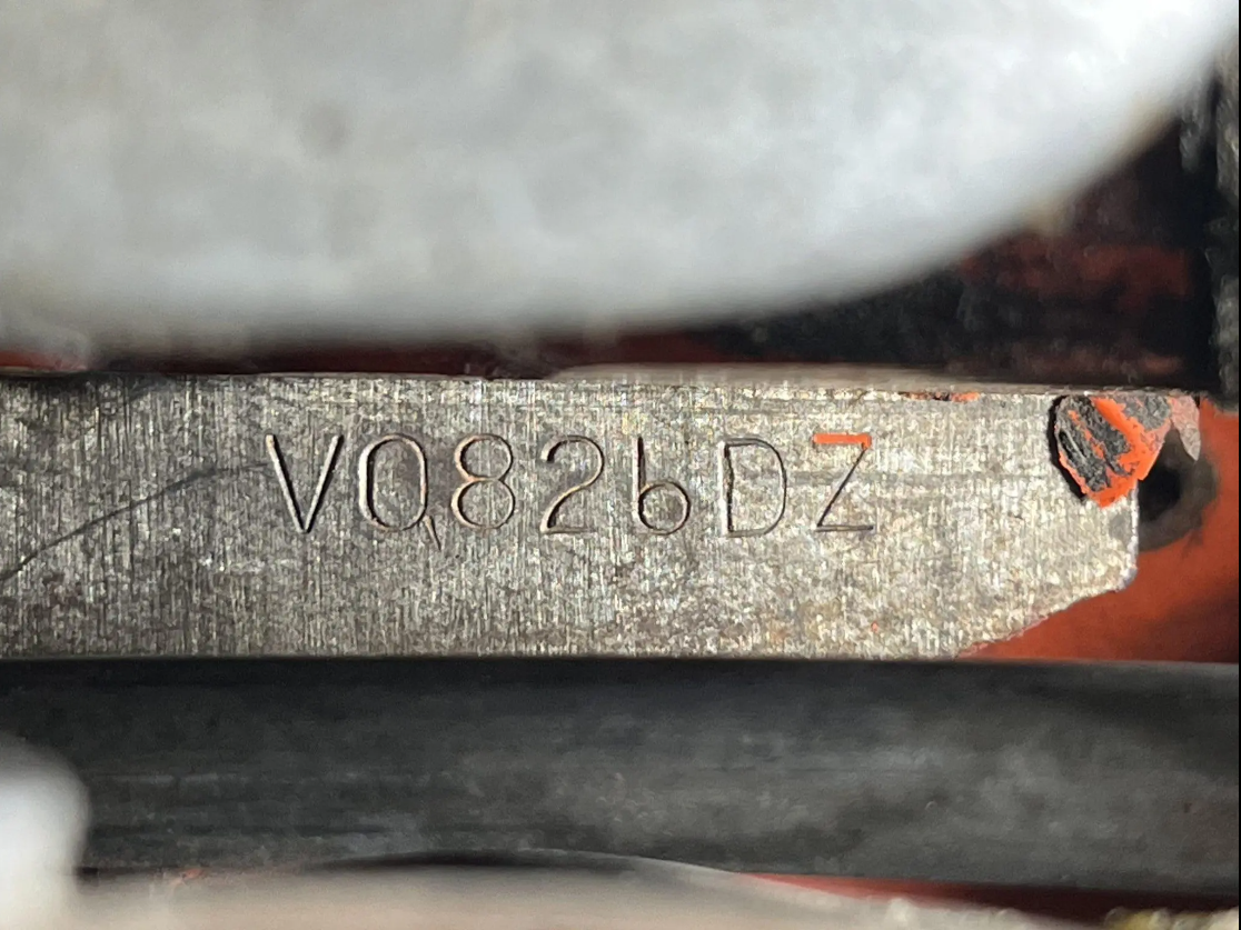

This one is a carbon copy of the one I sold ages ago so it has my interest. What do you guys think about this engine stamp?

Broach marks look real fresh, and the O and the 6 do not look good.

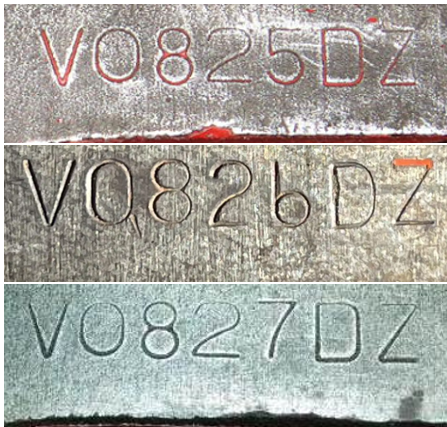

Which photo does not compare with the other two?

While I’m no expert, the 0,2, and D are inconsistent with the shown examples.

I agree, the 0 and the 6 doesn't look correct. I'd also guess that it is a fresh stamp and was stamped by a left handed person as they are deeper on the left side.

eights, twos d and z (top)

Problems with the broach marks too.

----Yes, They are not paralel in some places if not all!....Bill S

It looks like an actual L or a 1 that they but a small 0 on to make a 6!
