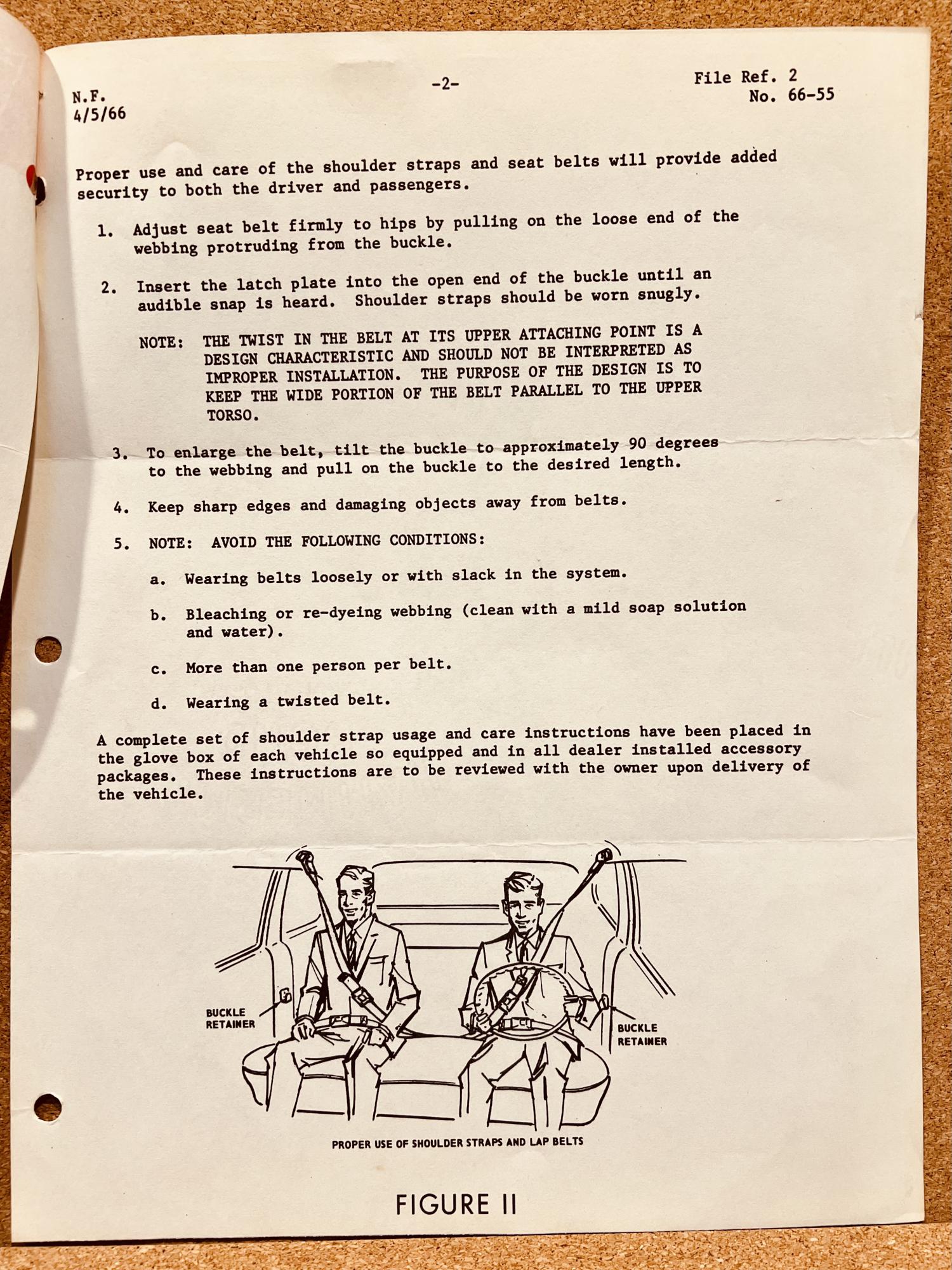

I love two tone painted cars and they are rather rare.
General Motors Corp.
Front Seat Shoulder Straps.
3/16’’ hole stamp in the body number plate.

Here is a 66 Nova SS trim tag removed in 1978 for comparison. It's also a Norwood car (most were willow run)It has the hole referenced by that GM bulletin
