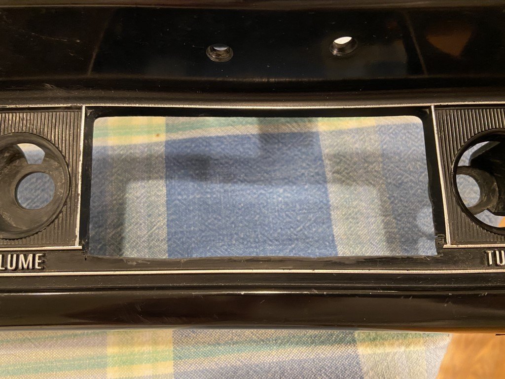

The area where the bottom of the radio opening was cut out was also repaired using the molding putty.
Name:  Radio cutout.jpg
Radio opening rebuilt, knob holes filled, and new tab added
