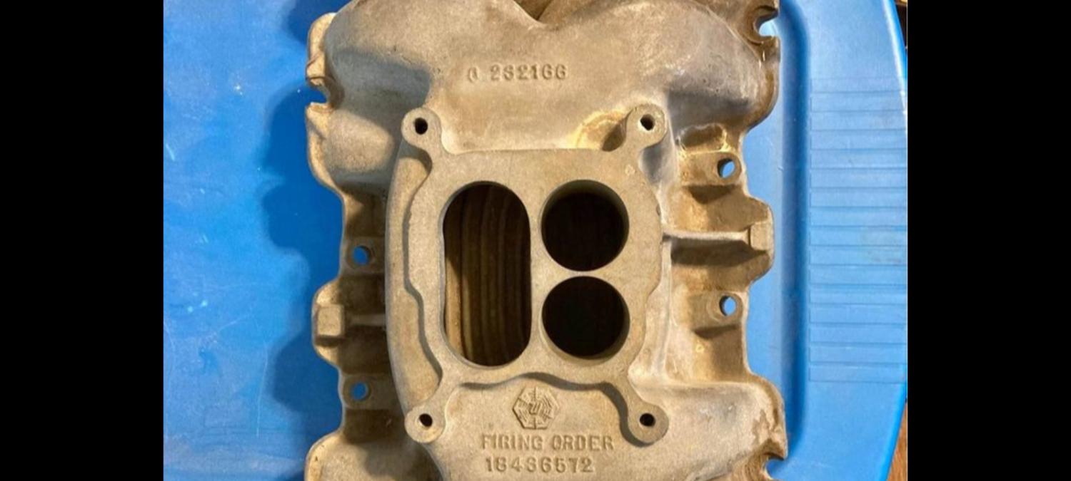

What intake is this? Thanks

409

Or 348. Nice piece you got there.

I can't find the casting number anywhere. Does the o in front of the casting number means pre production or experimental?
Yep.

That a Daytona Mystery Motor manifold.

That is what I am thinking but all the pictures I see of mystery moters show a different casting number.

There’s more than one casting number when it comes to those MM manifolds.
