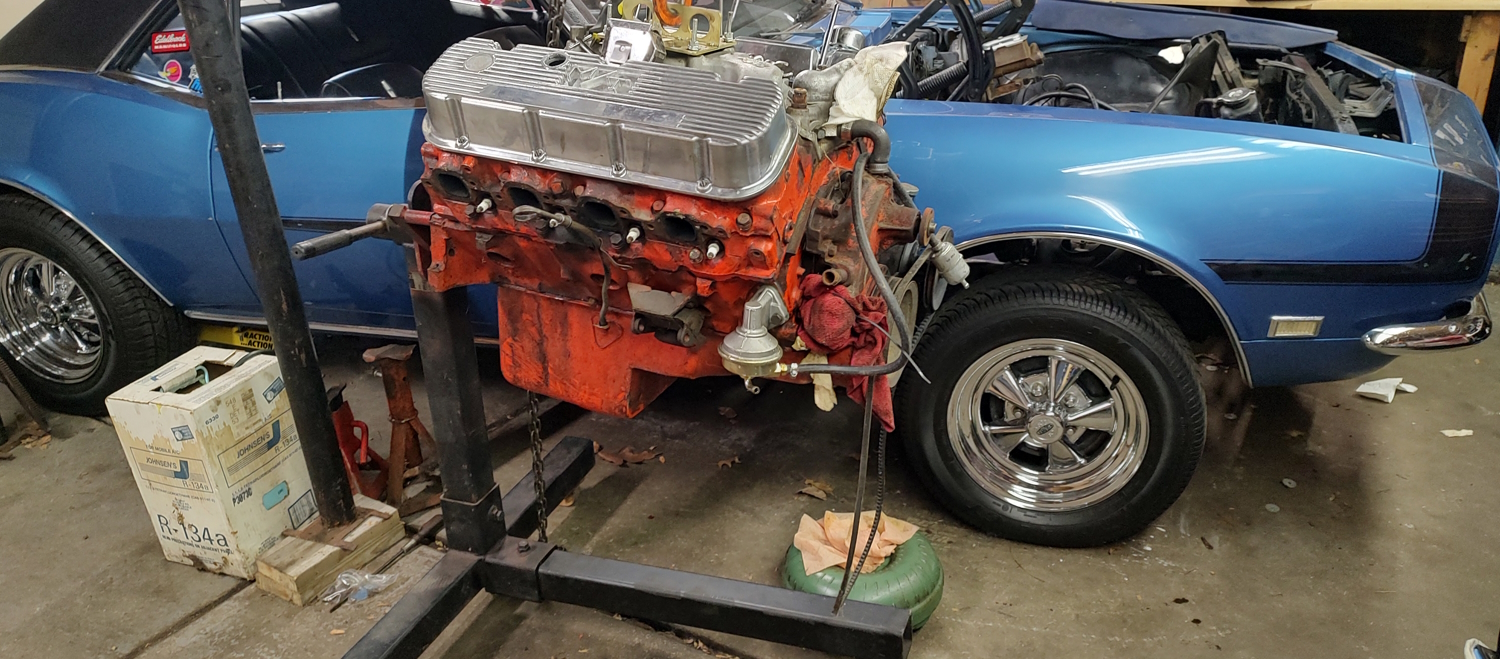

Got a stand for free from one of my best friends. His dad's moving back down south and didn't want to take it with him so it became a birthday present for me. I'm still hoping to tear down and rebuild over the winter. Please excuse the mess in the garage. As soon as this car runs again, I'm going to completely clean everything.

Pulled the pan off tonight. I could feel the grit in the bottom of it. I'm very glad I listened to the folks on here and my friends outside of here who told me it needed to come out of the car. Might check one of the bearings tomorrow just to see how bad they're mangled. I know it needs a set regardless (and even if it somehow didn't. I see no reason not to do it).

May as well accept that the engine needs to come down to bare block, tank cleaned and start from there. That "grit" can hide all over in the block, especially oil passages and come back to haunt you.

Job's going okay. It's rough on the body but the pay's good. Call me hardheaded but I really, really don't want to go to a bare block. Afraid I'll never get the damn thing back together if I go that far. Who knows, I'll probably end up doing it.
