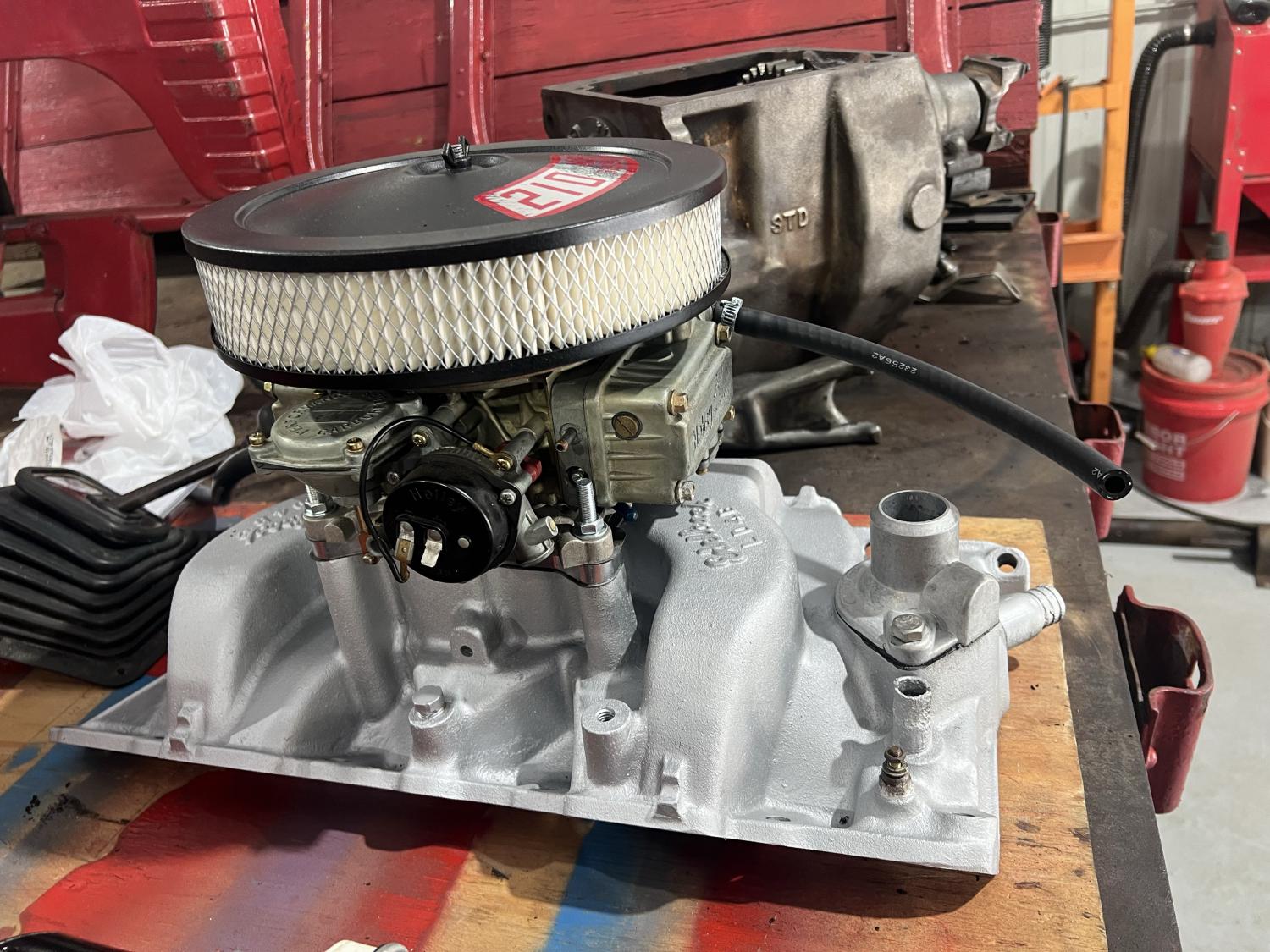

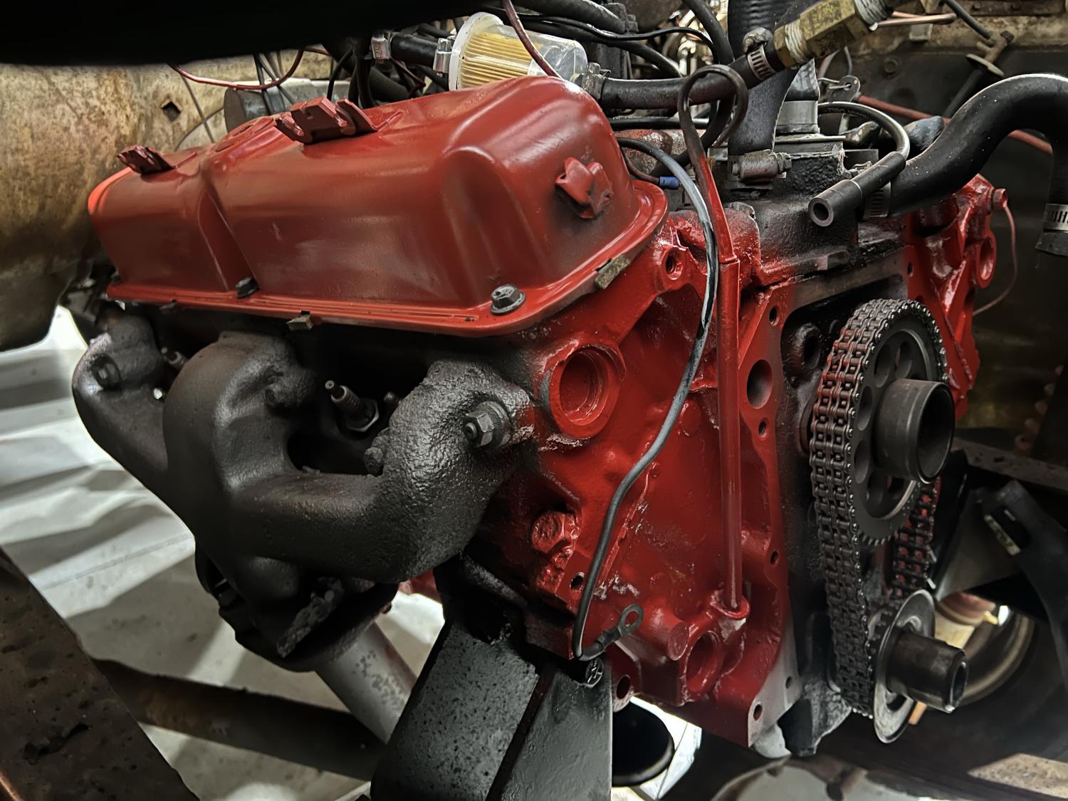

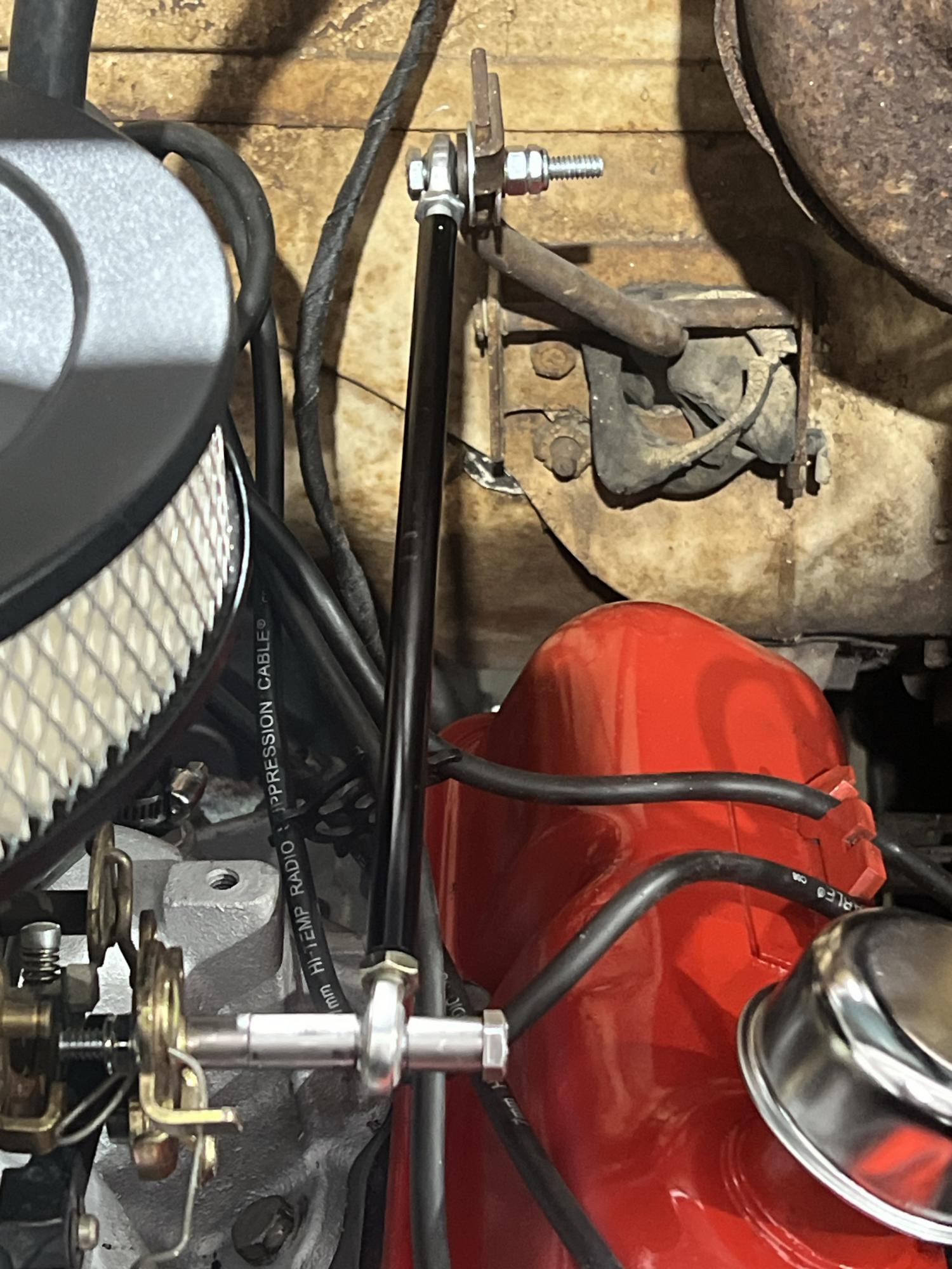

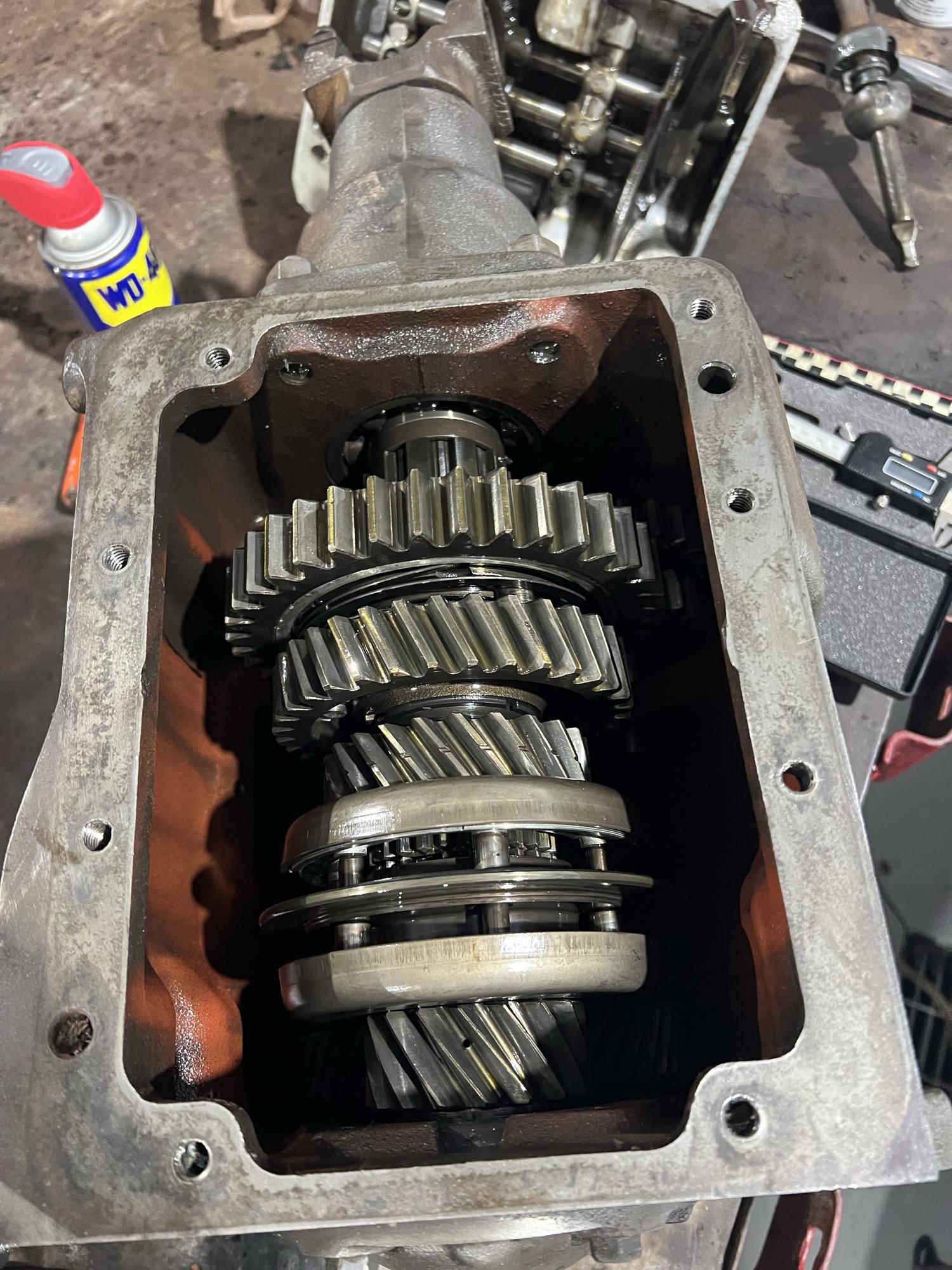

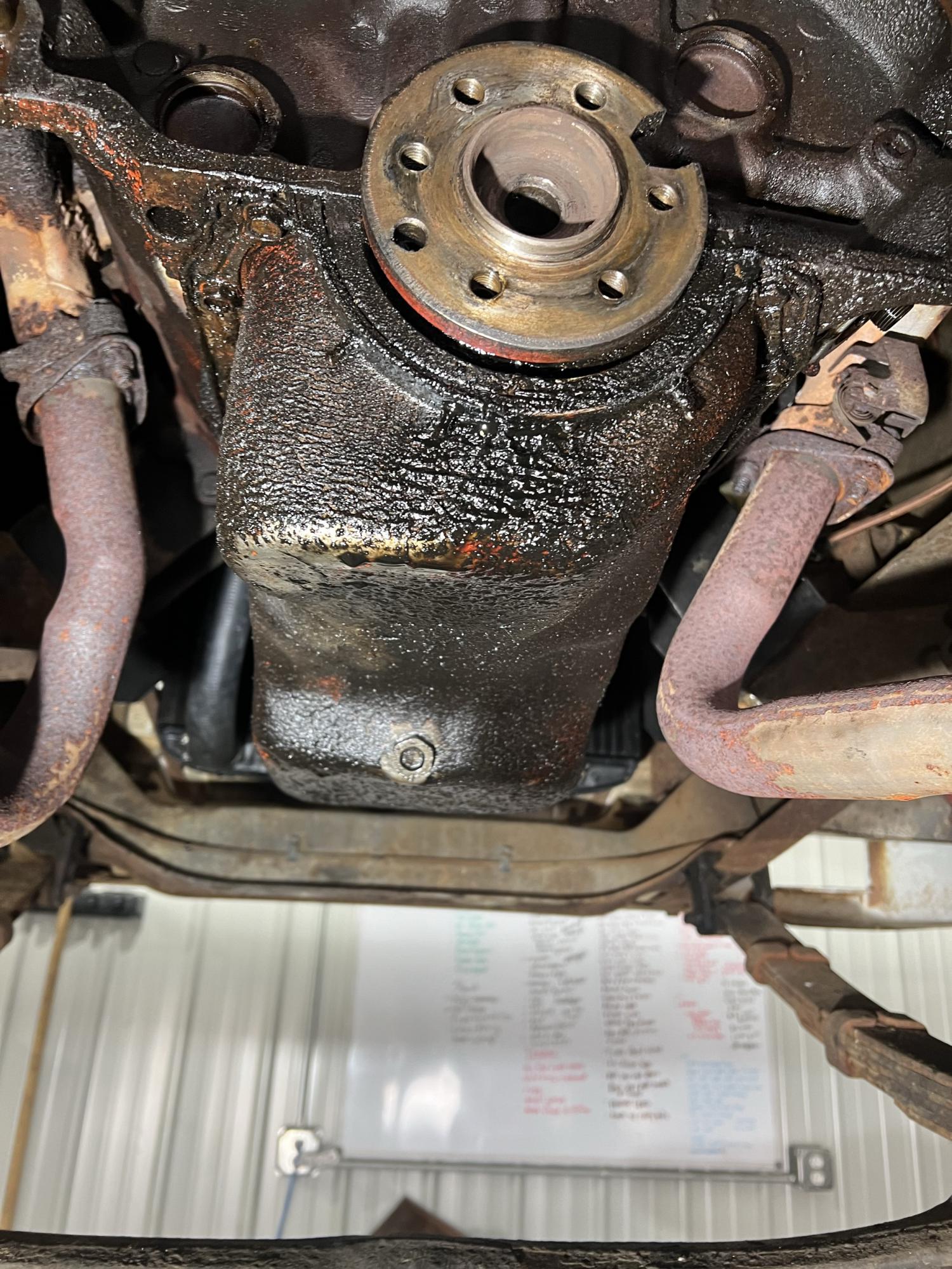

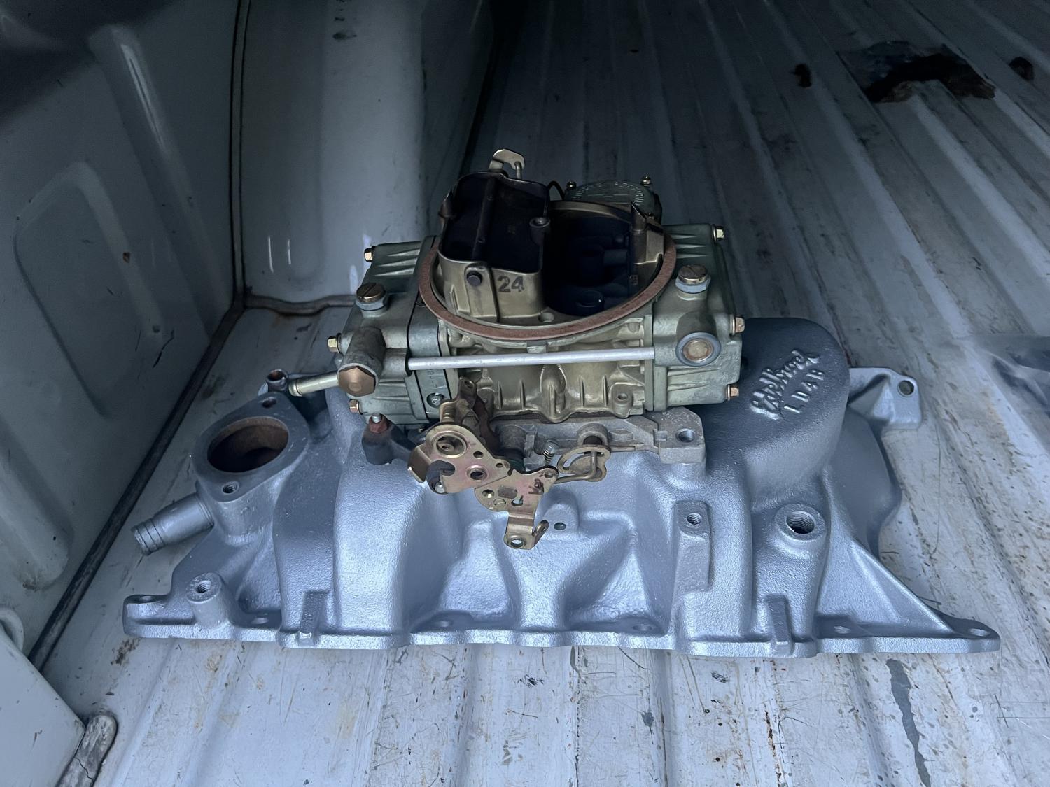

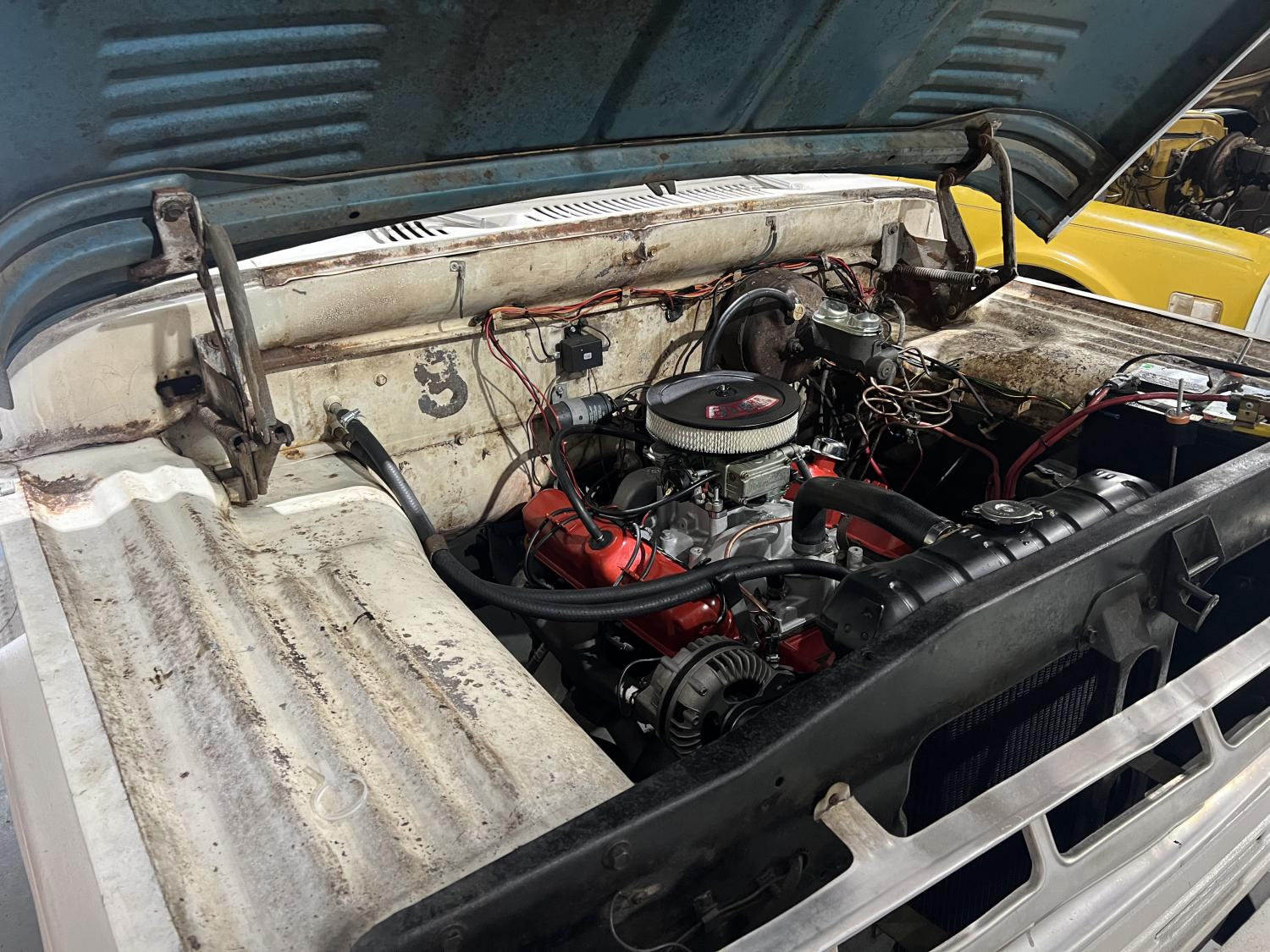

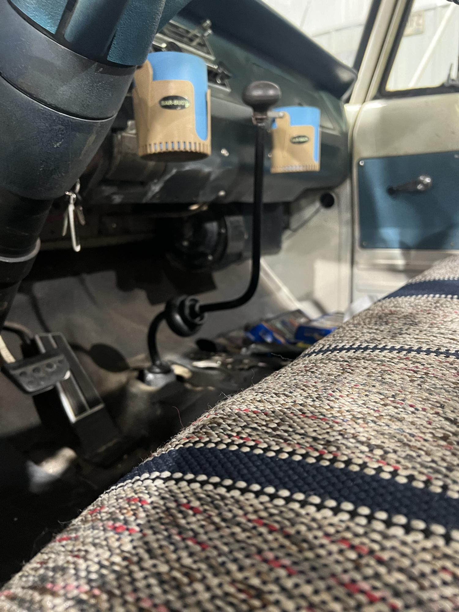

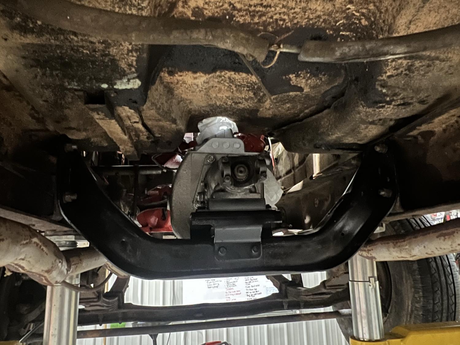

Well, I've been hard at work on this Truck for the past few months. I'll add posts as I get time to show the progress. I was able to fix all of the oil leaks, replaced the timing set, cleaned the engine up and repainted it while I was doing the fixes and upgraded the old 2 barrel setup to a vintage LD4B edelbrock 4 barrel with a small 390 cfm holley carb. Cleaned up the trans, resurfaced the flywheel and put a new clutch in and this thing drives like a dream now. Also figured out why the shifts were so sloppy. The shifter cane tip where it engages the shift rail in the trans was heavily worn. Fortunately, I was able to source another one from a 1963 parts truck that looked almost new and has a different bend in it so the shifter is in a much more driver friendly location with shorter throws between the gears!
