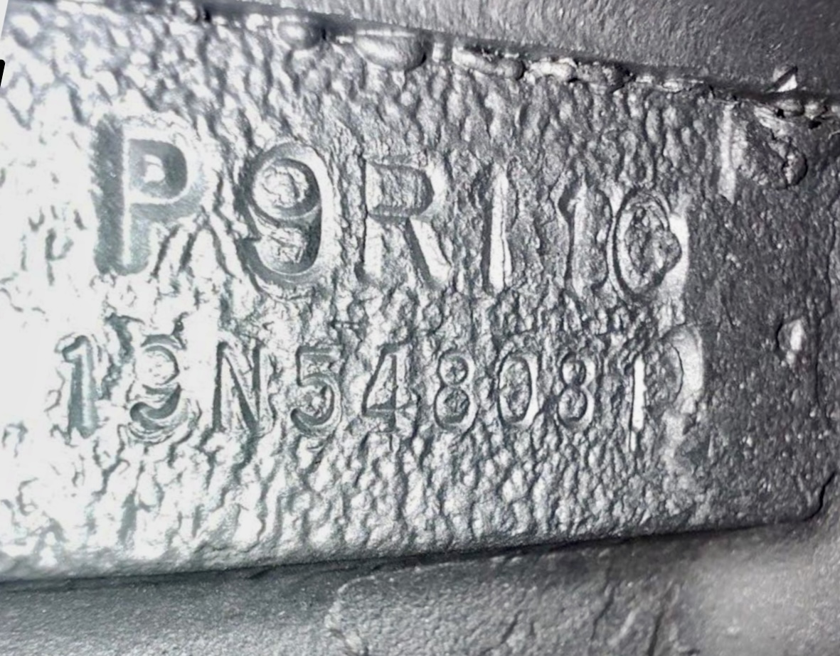

The trans stamp P 9 R11 C? (Oct 11). If so it would be to early to have the "C" at the end. Carb pictured is 924 (4th week February 1969).

Transmission is a restamp. As Danzo says, too early for C suffix which was a running change in late calendar year 1968. The POP doesn’t have a C on the transmission code. The partial VIN stamp on the transmission doesn’t match the pad stamp, easiest difference to spot is the numerals 1 and 4 which are entirely different fonts.
