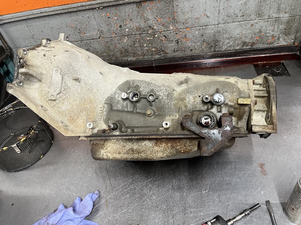

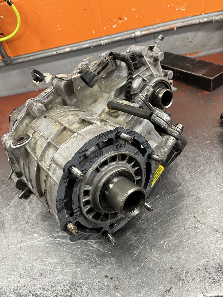

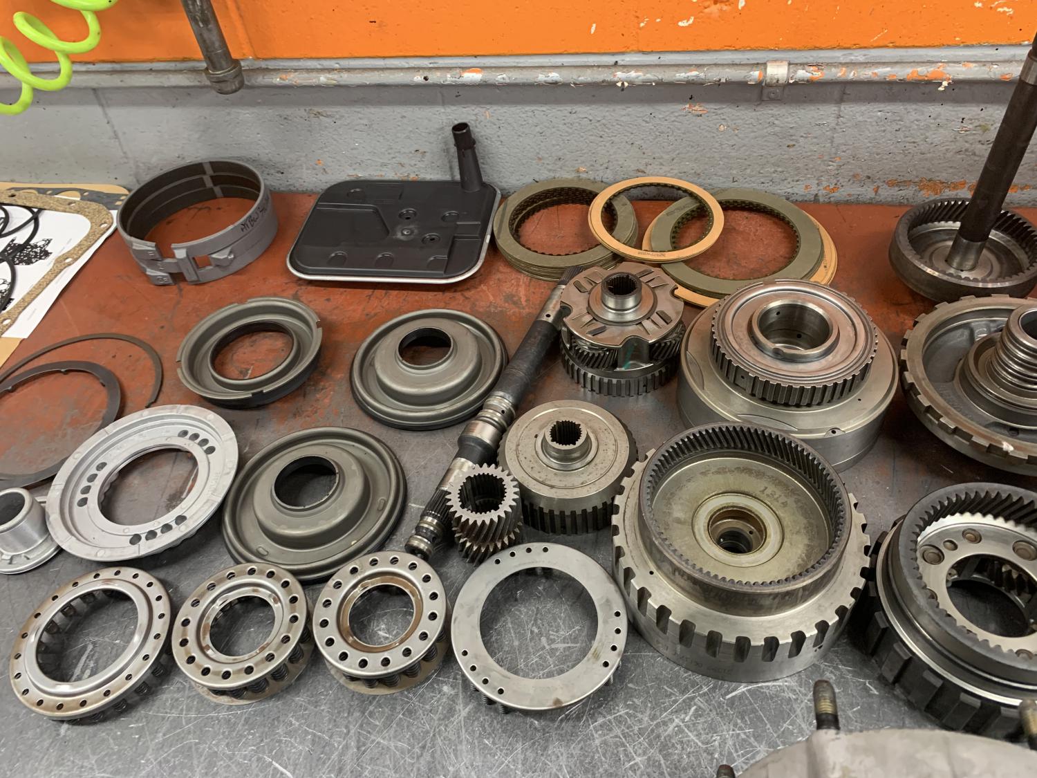

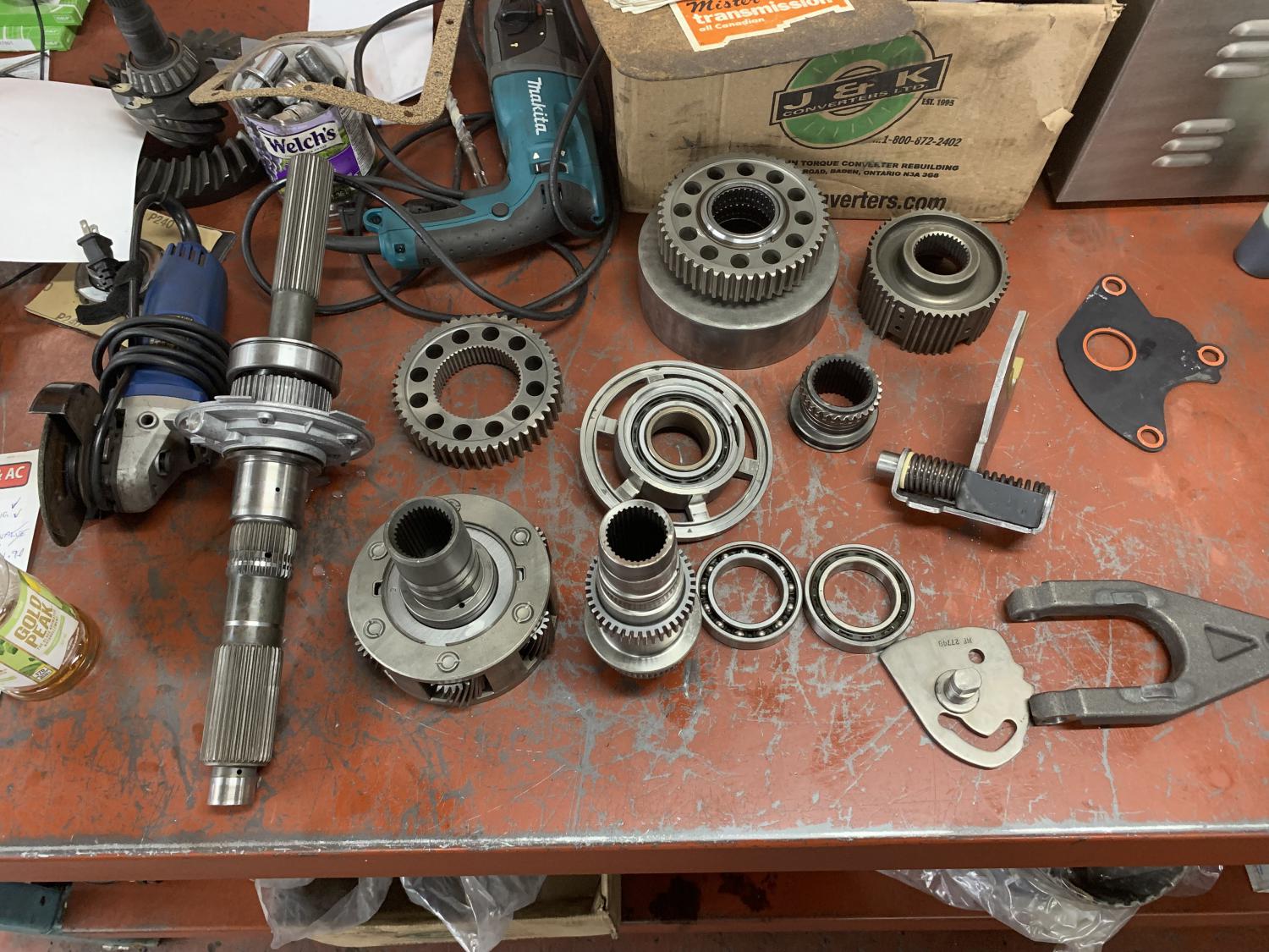

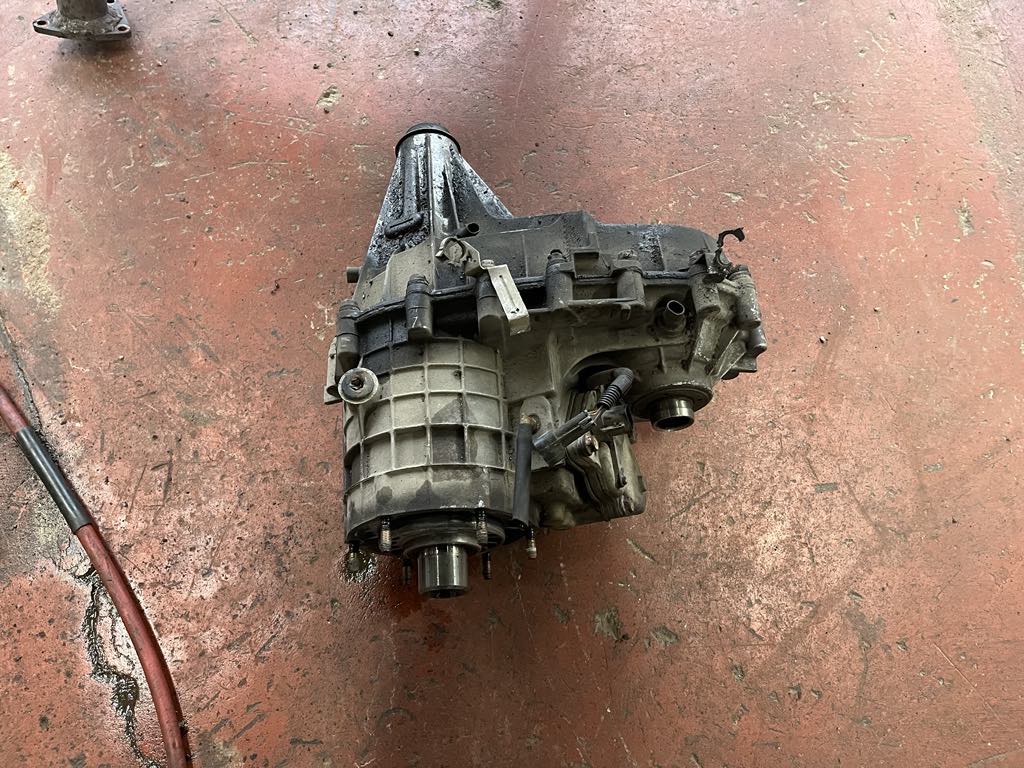

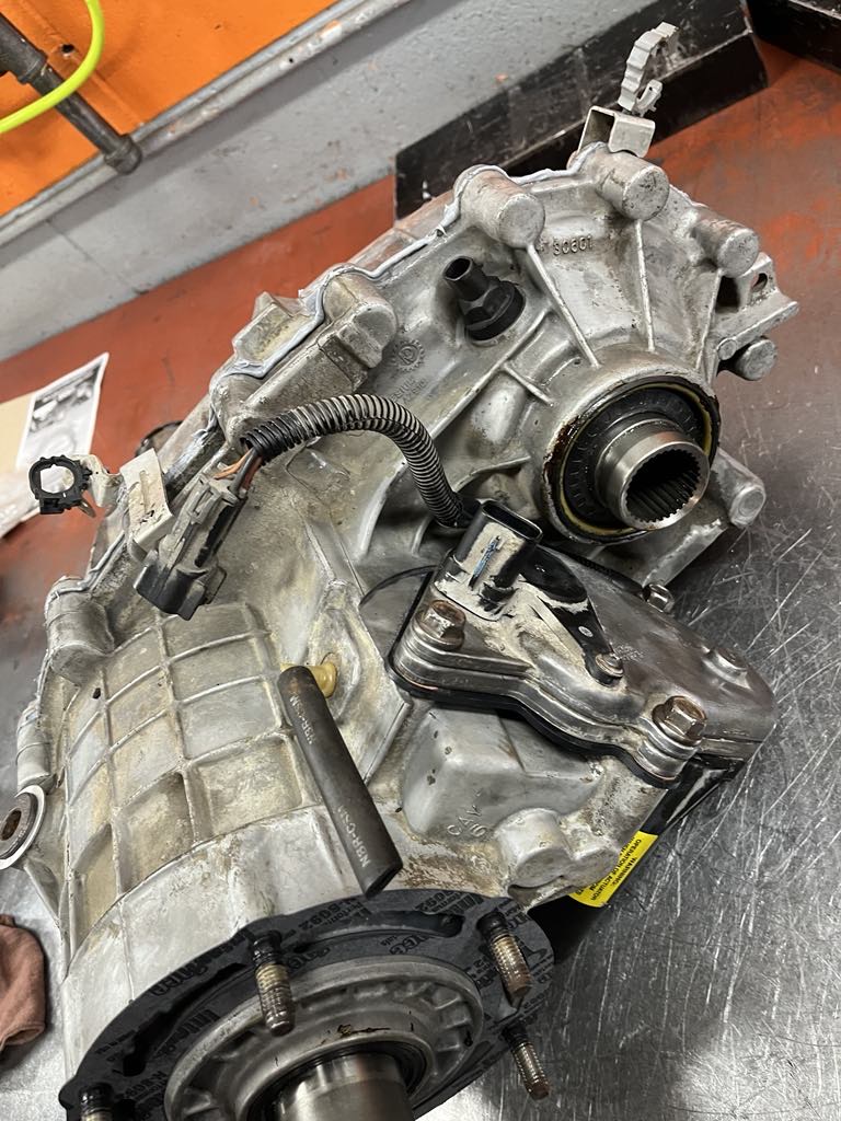

So major plot twist with my truck preparations…… having spent my entire career in industrial Maintenace I have learned that there is a perfect time in a machines life cycle to do a preventive overhaul. I decided my transmission and transfer case were due. Mr Transmission in Brantford just happens to be owned/operated by my friend Des Ryan (Tracker1), so they are doing a once over of the drivetrain in my truck to make sure it is reliable for towing.
This was all planned and budgeted up front and I’m very happy that this work is being completed before “towing season”
Billet lock up torque converter,
Larger trans cooler
Case saver kit, chain, and rebuilt kit for the T case
Trans rebuild kit, plus towing shift kit, plus a couple other upgrades
U joints for the front drive shaft
Front and rear differential service
This is like a spa week for my truck!!!!

  #73
Old 03-27-2024, 12:48 AM
Ryan1969Chevelle's Avatar
Join Date: Nov 2012
Posts: 5,992
Thanks: 615
Thanked 945 Times in 480 Posts
Default Transmission
Transmission Transfer Case

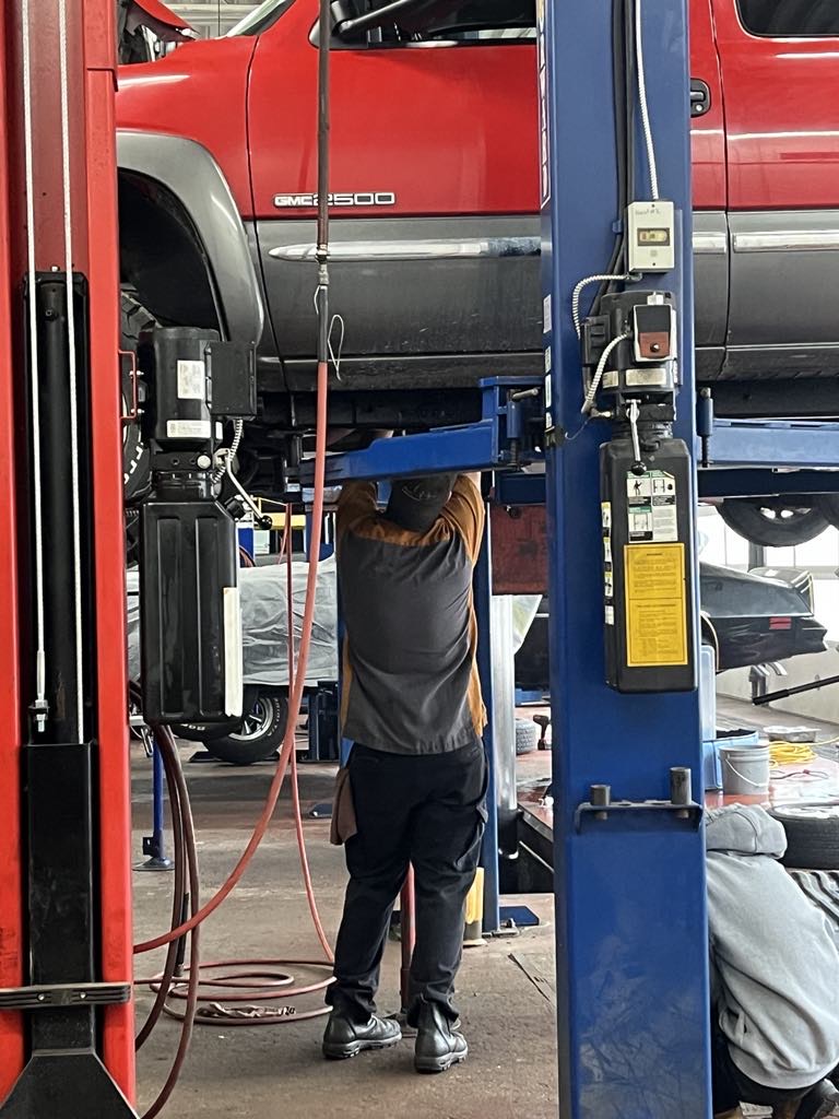

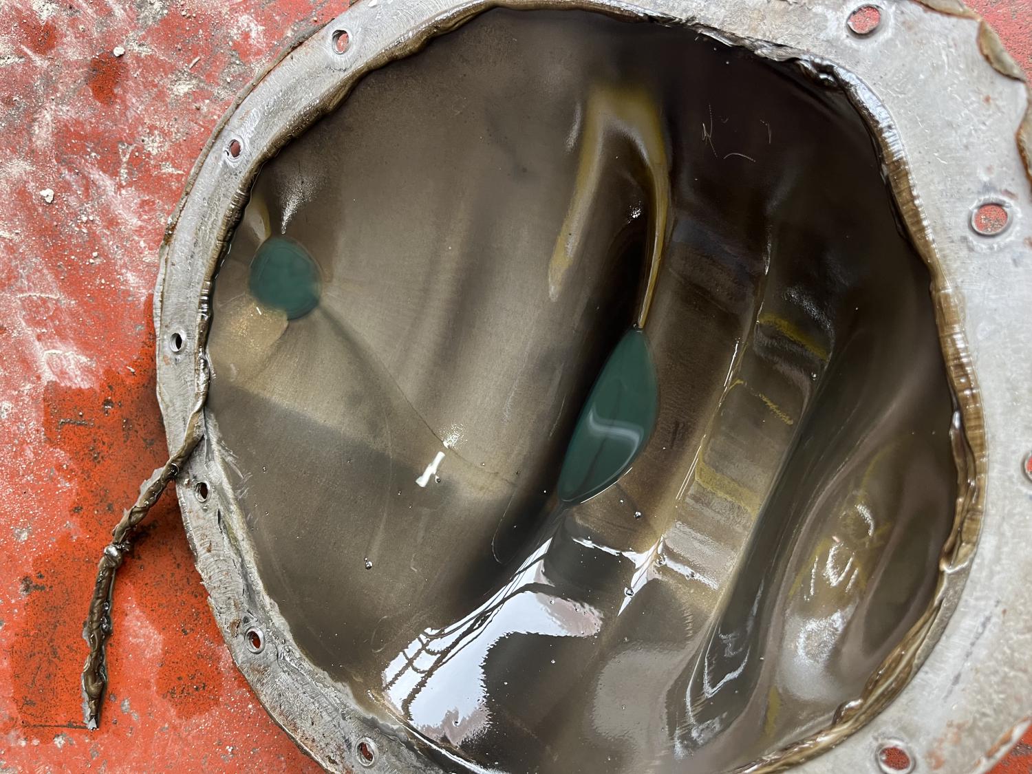

Truck update:

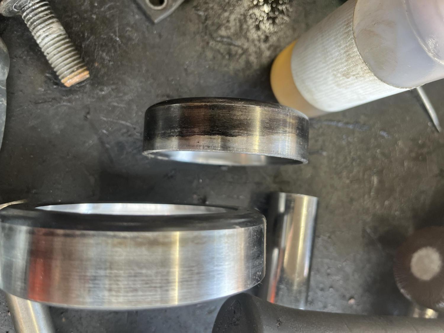

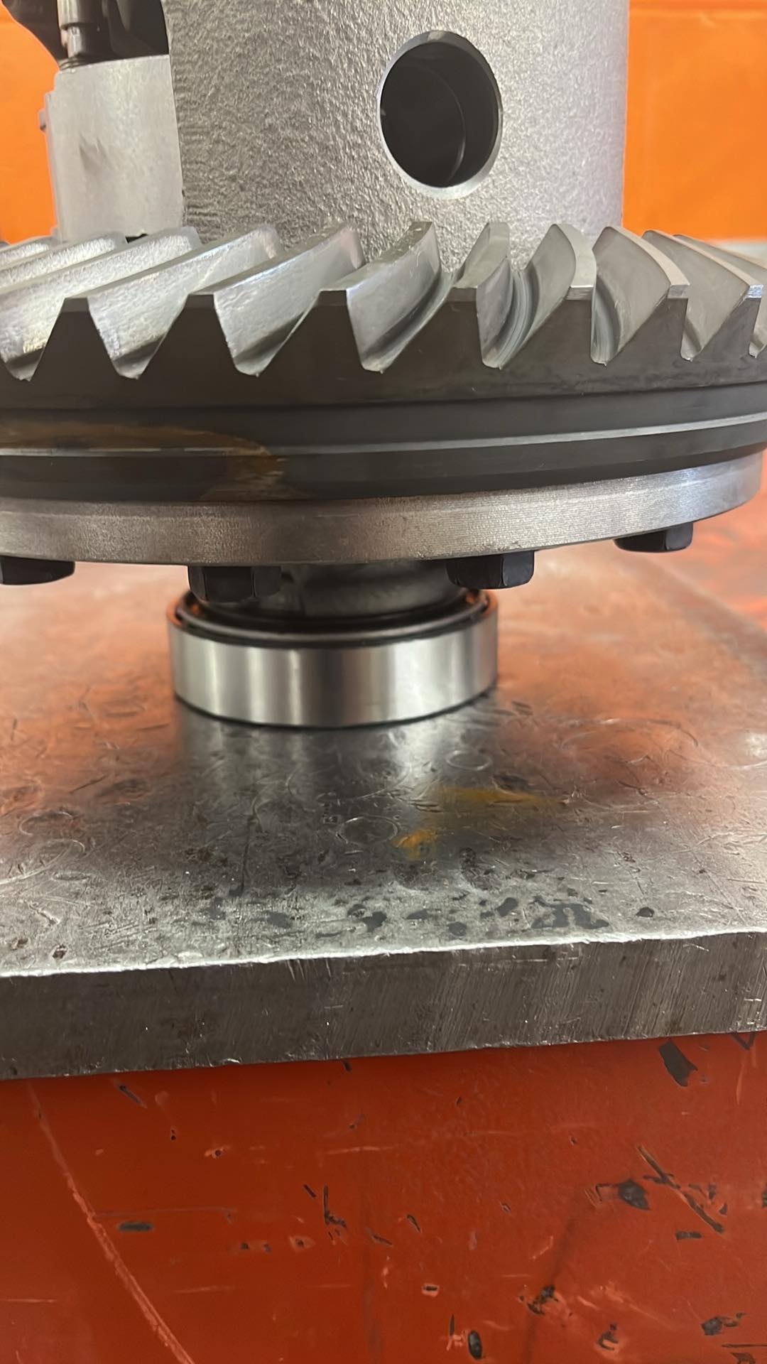

Front and rear differential service today, no issues found, fluids were ok, no metal, moving ahead 🙂
Mr Transmission Des Ryan is answering my 1000 questions!!! 🙂 and providing more pictures than a new parent 🙂

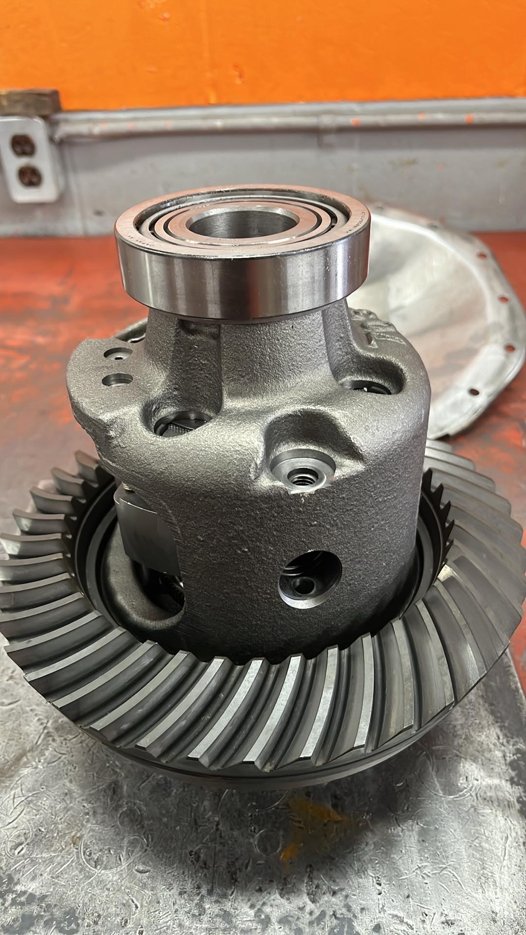

Old 03-27-2024, 09:20 PM
Join Date: Nov 2012
Posts: 5,992
Thanks: 615
Default Diff
Pics

Rear end freshened up and set up.
New bearings, seals, and set up.
Getting close now!!
Ryan W31

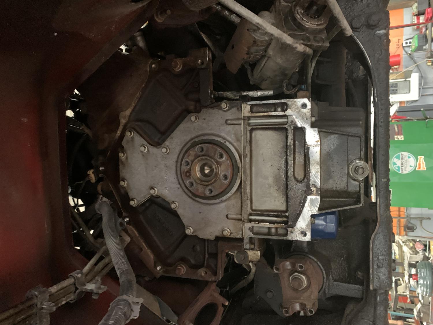

Truck update:
To do a full drivetrain look over it seemed appropriate to have the engine looked over. Des had a tech savvy shop scan the engine codes, and check for issues.
Two knock sensors, intake gaskets, sensor harnesses, and two 02 sensors later she’s ready for the road.
These items are about the only repeat issues that show up during the thousands of internet searches I have done for 6.0L 2500 known issues so I wanted to address them ahead of towing season.
These items will also affect power, mileage, emissions, catalytic converter life, etc so that’s all positive.
