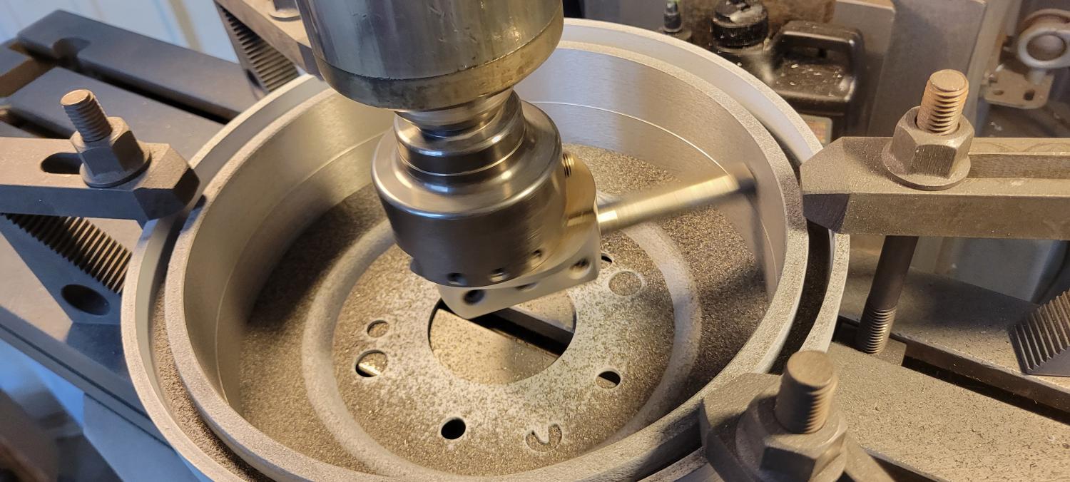

Default Brake Drum Boring
I only had one orignal brake drum, but cleaned it up and bored it out. I see they now sell some non finned new replacement drums. I may have to just get one.

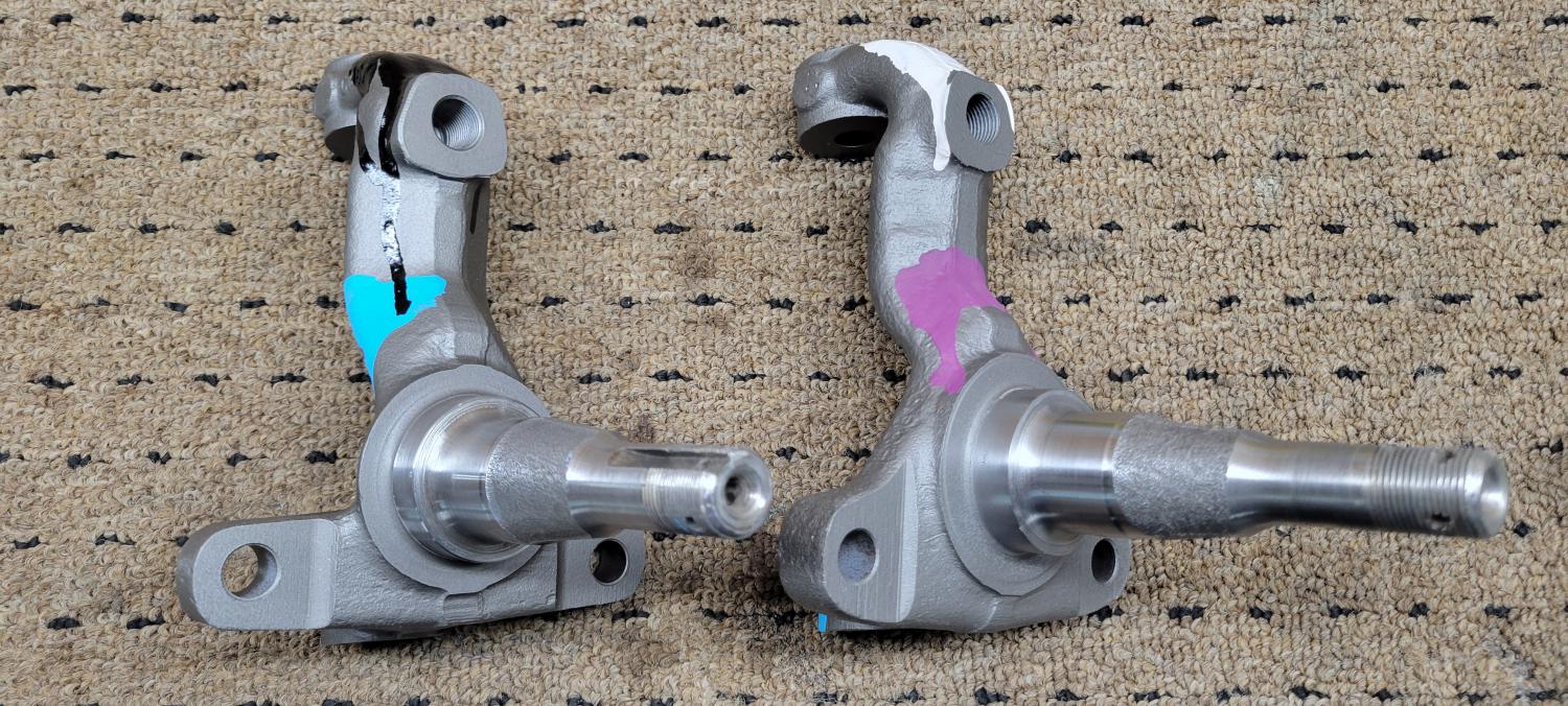

Default Axles and other bits
Most times im real neat with the paint marks but the axles clearly showed the paint dripped all over so this was kinda fun to do.
I’ve thought about doing this on a Bridgeport. What tool did you use, and how did it turn out?
Just a standard boring bar with 5/8" bar and carbide insert. I think they turn out nice but sometimes you do get some chatter. I had to really slow down the spindle speed to almost the min the machine would run to make it all work.

Thanks! I’ll be trying this soon.
