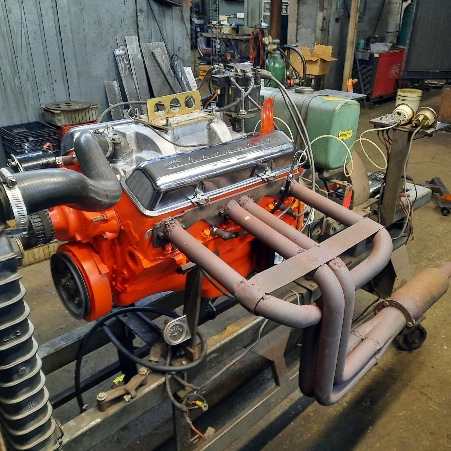

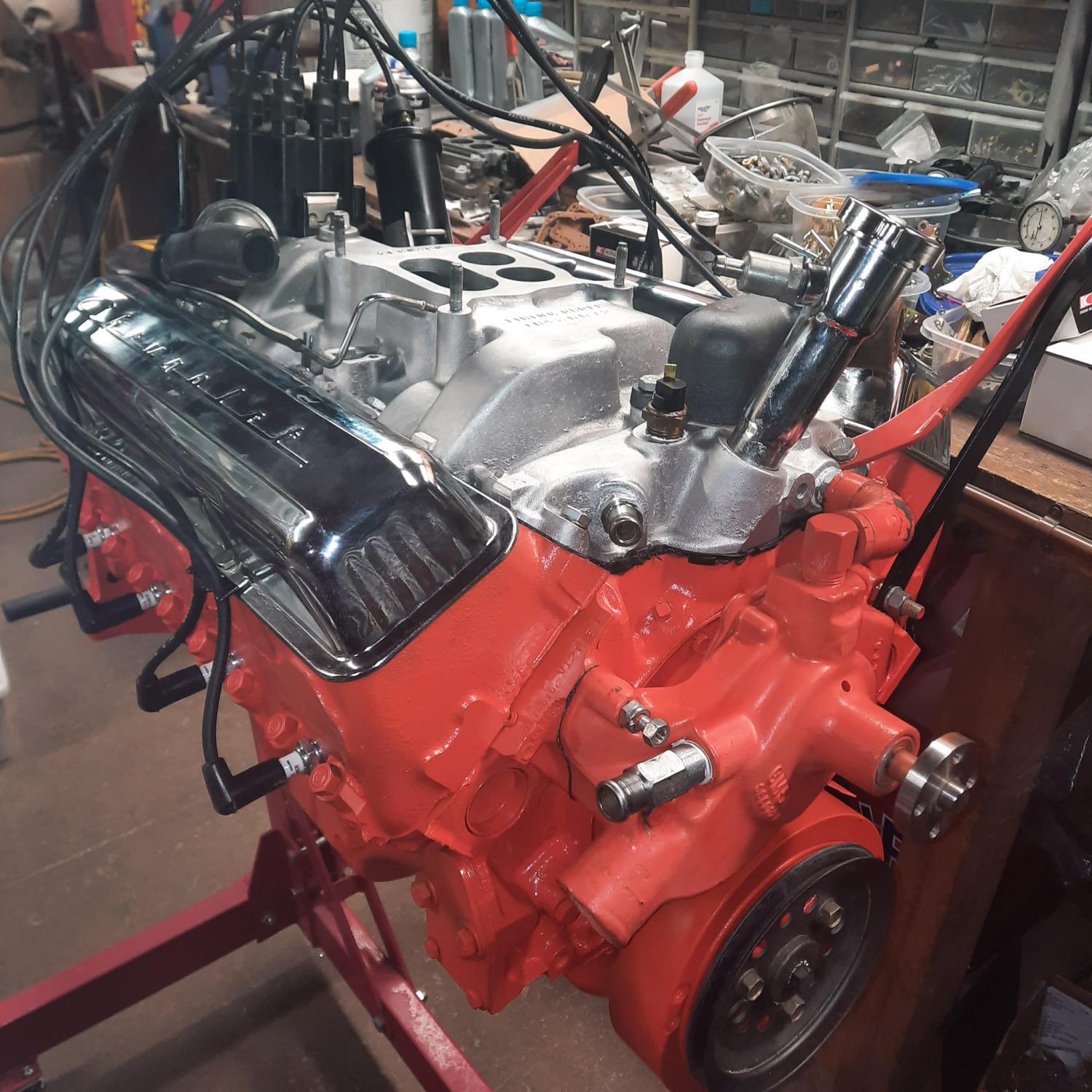

Here's a few pics of the assembled engine under different lighting.
