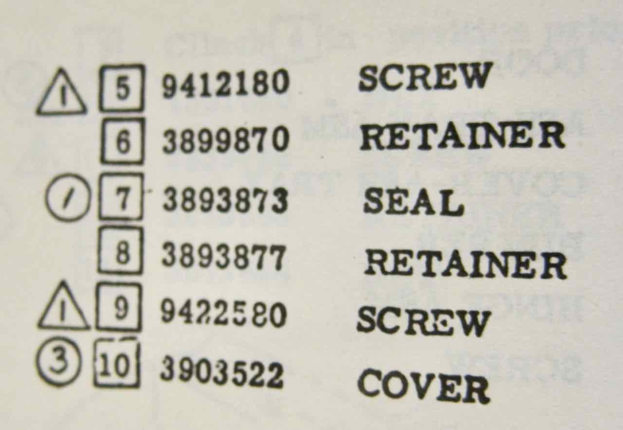

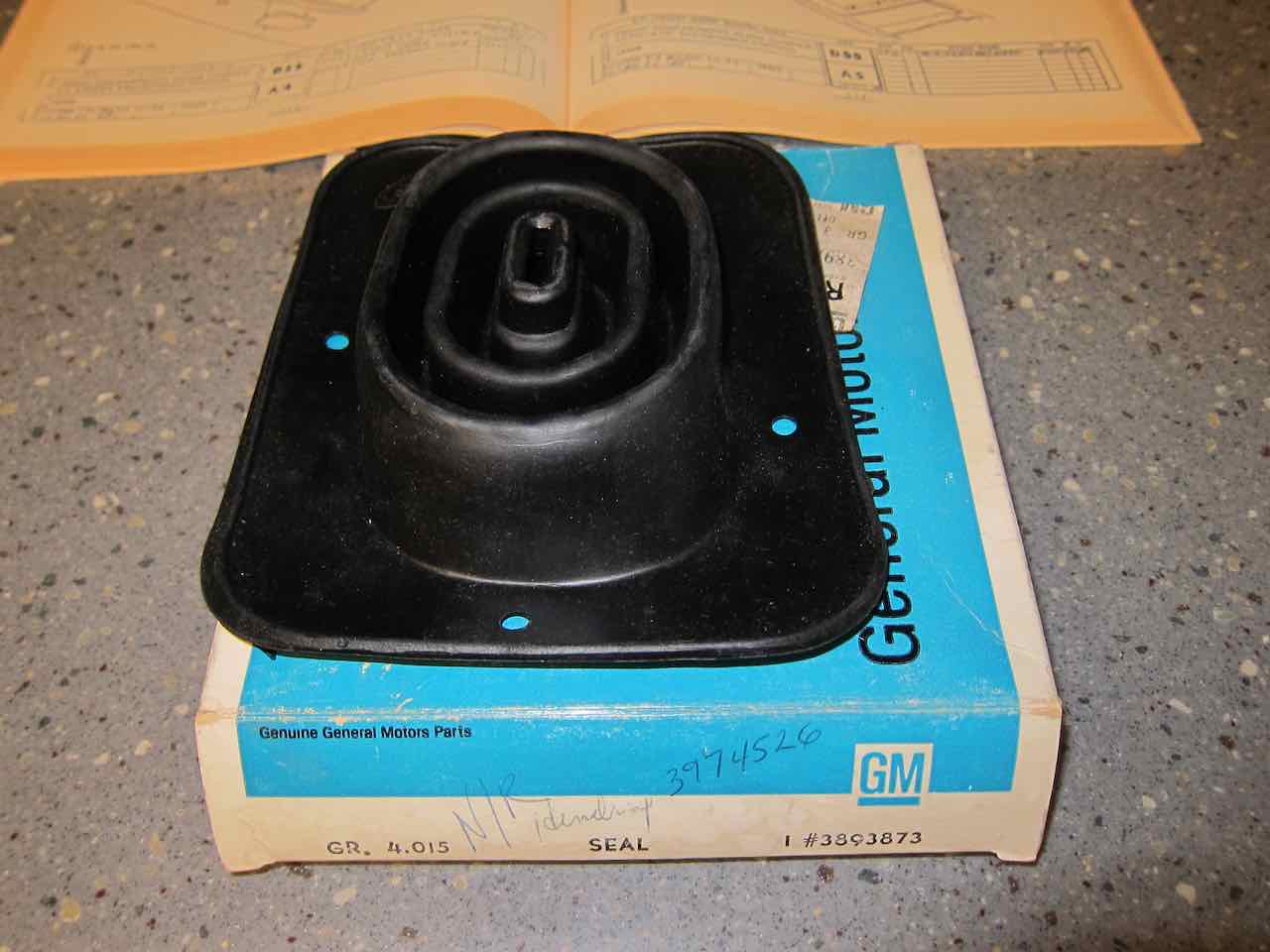

Are you planning on installing the console ? If not, the pic of the silver retainer would be correct. If you are, I wouldn't worry about the lower retainer, as it will never be seen. This an NOS upper boot and top plate with the console. This boot looks like the one you had in there and replaced, It may be the correct boot for the console mount ?? I am using my old auto retainer at the floor too,so no pic of a correct one.

"IF" 67 & 68 Console Factory boot are the same <Someone check AIM's?>
