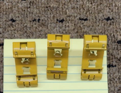

Default Brake Line Clips
Ive seen other cars that utilize p clips and bolts for the brake line. My car actually had the older style clips. They still had some mustard color under the brake line but were mostly rust. Still very good shape and cleaned up nicely. I also noted the assembly manual showes p clips and bolts.

Those 3 clips are from that frame ? Did u restore them already and if so how? Your frame looks like it will clean up real good.
