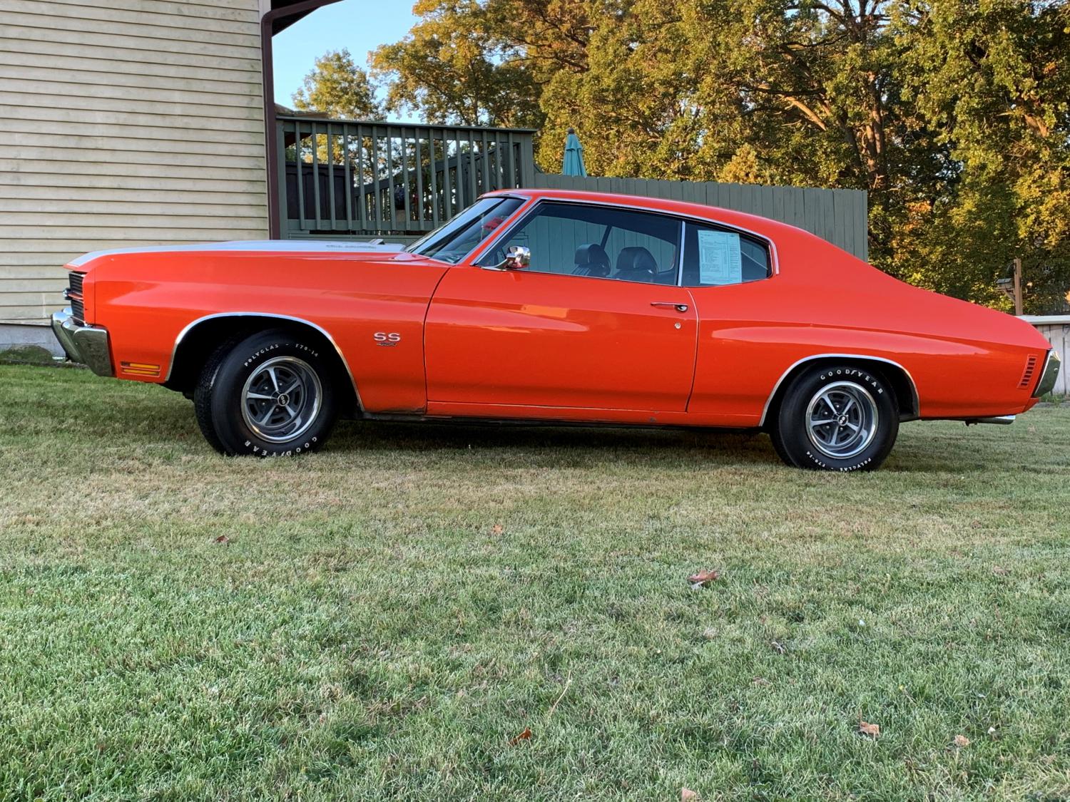

Ive read some years ago about the special paint cars on how they were" painted", not on the process of special ordering of the color thru COPO, that I have. Does anyone have a link on this? If memory serves me body was painted on the Fisher side and front end in the body shop side, then they were assembled later. Any help or direction would be appreciated. I thought I bookmarked this but I cannot find it. I've owned my car now for 39 years this year. The front clip is a little darker then the body, I cannot find any evidence of a complete repaint or sheet metal replaced on the dog house. all hardware is original and not mismatched with all the correct markings. By looking at the car I can see red oxide primer in the door jamb on the body, front end looks like it was painted over the black e-coat, which could explain the darker color. Dunno TIA

What a beauty!

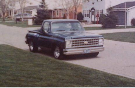

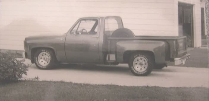

I did not remember this but in the '73-77 timeframe you could not order a LD squarebody pickup in "black". It was not available as a regular production option. You could, however, order it as a COPO and tap into Specialty Equipment Option 9V1 and access the black available for fleet and Medium Duty trucks. We had a '75 2wd Short box in black, but I did not remember dad saying he had to do anything special to get it. It became a regular option in '78. K

Thanks Keith for you're knowledge. It was very informative. It just bugs me that the front end is a little darker and having to explain to some people why it doesn't match and I really don't have the correct process on how this was done to explain. people think the front end has been messed with. the only thing I can find on the car is the right front fender was repaired and blended right behind headlight bezel, I can see the blend. Actually it's been hit there twice. I got hit and run when we had the car at Chevell-a-bration in 2009. I re-repaired that spot and blended a blend with another. Nobody has ever noticed or said anything. Thats the only thing on this car I have ever found. I'm the second owner of 39years, original owner since got killed in a helicopter crash shortly after buying car, so I couldn't ask him any questions regarding car. If only the car could talk

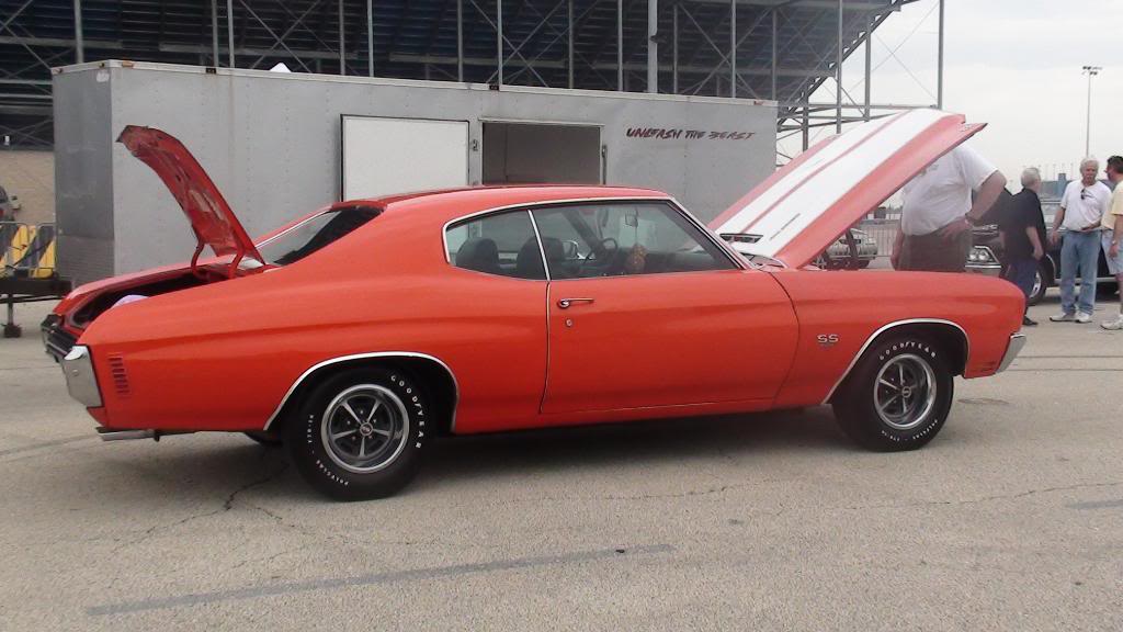

SCR, don't remember the year in Joliet IL

2010 or 2011?? I love this car, I remember checking it out at SCR.

Dave - doesn't that kinda look like Dad checking out under the hood in Slims picture? |
