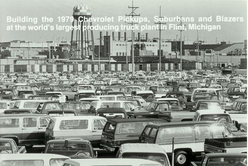

Nope; nothing to do with the model number.
1980 Blazer model number would be K10516 btw.
And - would have been built in Flint. I might have seen it go by
K
https://www.gm.com/content/dam/compa...let-Blazer.pdf
CC10516 = Chevrolet, 2wd Blazer
CK10516 = Chevrolet, 4wd Blazer
TC10516 = GMC, 2wd Jimmy
TK10516 = GMC, 4wd Jimmy

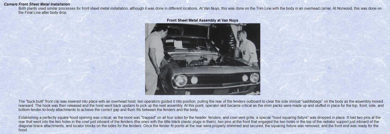

I'll add that much of this is discussed in JohnZ's article, including the difference between LOS and NOR front sheet metal. http://www.camaros.org/assemblyprocess.shtml
