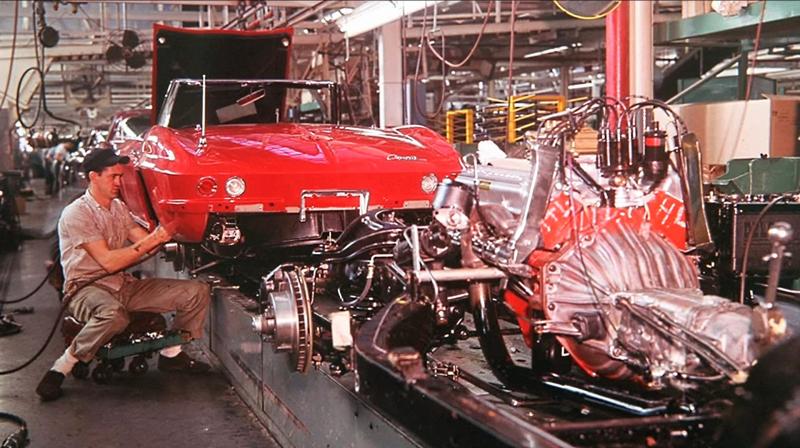

A preservative-black paint was applied to the exhaust system after its installation on the chassis but prior to body drop. The preservative paint was applied from above the chassis with a mitt/mop. Moderate to even heavy paint application was common on the top and sides. Paint runs and drips were common.
