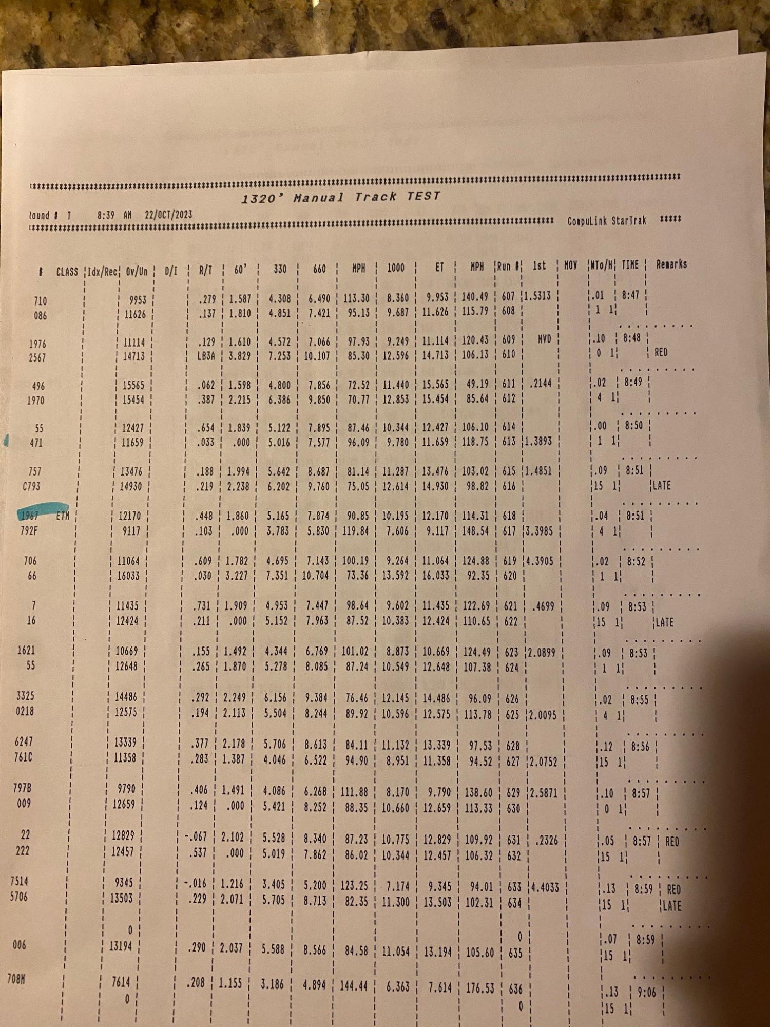

We had a blast at Pomona. Good times with friends and family. I got to make two passes, should've been three but I blew a heater hose in the burnout box and had to get pushed off the track haha. Talk about embarrassing in front of almost full grand stands Best was a 12.17 @114mph. The car was starving for fuel (sputtering on the big end at the top of 3rd gear and 4th gear) so I made a jet change and it actually hurt it more. Fuel pump can't keep up with demand....
I was really thinking it would run high 11s considering the weight of the car, over 3600lbs without driver, and the 3.55 gears so I'm close. I am going to convert the car to 1/2 hard fuel line with a 1/2" pickup and an Edelbrock mechanical pump.
